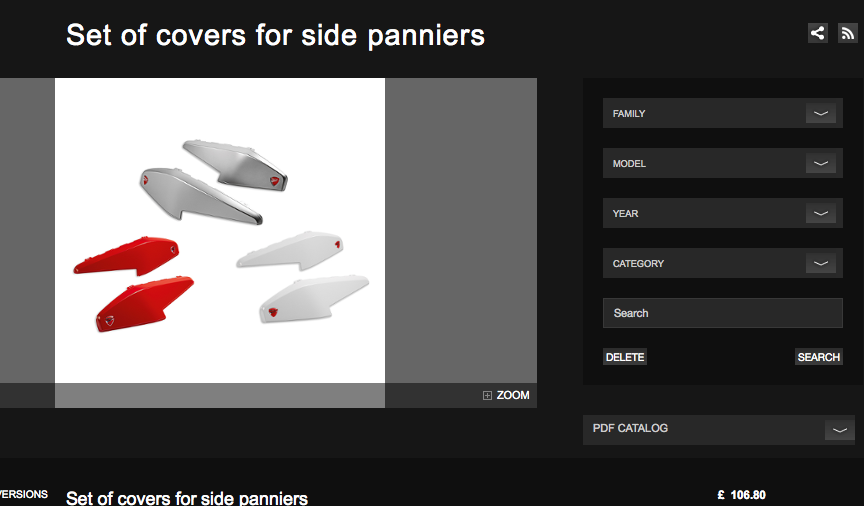

  1. The panniers that came with my bike had the silver insert and I would really like the red ones however I dont want to be fleeced for the £106 Ducati want for 2 bits of plastic. Has anyone sprayed theirs of had a vinyl wrap applied?
  2. bump thread for attention'
  3. It would be difficult to respray them without messing up the little "Ducati" logo. I wonder if it is possible to buy the logoes separately?
  4. I might be interested in colour matching the pannier and top case panels, but not at £106.80 and £85.40 respectively for the Ducati parts.
    @Pete1950 - looks like Ducati sticker on the panniers might be the same as those on the nose of the fairing and the rack (both part number 43819301A)?
    Update: Just found the Pannier Installation Instructions on the ProItalia website. It has a parts list of all the pannier moldings as well as the brackets and rubbers. The sticker on the panniers is the same as the others on the bike.

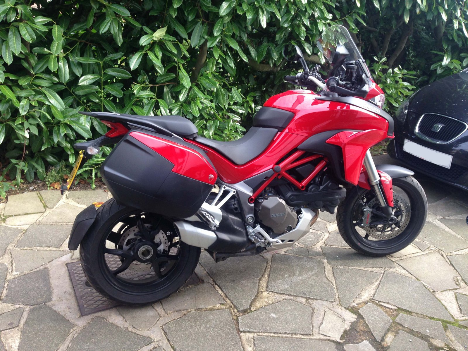

  5. IMG_6283.JPG I have a Givi top box from my Triumph Tiger Sport and the original panniers as part of the touring package, so decided to paint all of them to match the red, came out ok, just need to order the rack, Givi don't sell this yet, but a dealer will order me the rack separately so alls good.managed to remove the Ducati badges and refit them, not perfect, but good enough for me. paint supplied by RS Motorbike Paint Colours - Motorcycle paint, bike paint, Kawasaki Honda Yamaha great service and prices and quality very good, gives a nice finish.

  9. Hi B1stoboy, I spoke to Phil at RS Bikepaint (very helpful) the colour was Anniversary Red if I remember correctly, he supplied all the paint, primer and lacquer needed to paint these parts, actually very good quality paint too, nice finish, I was impressed.
