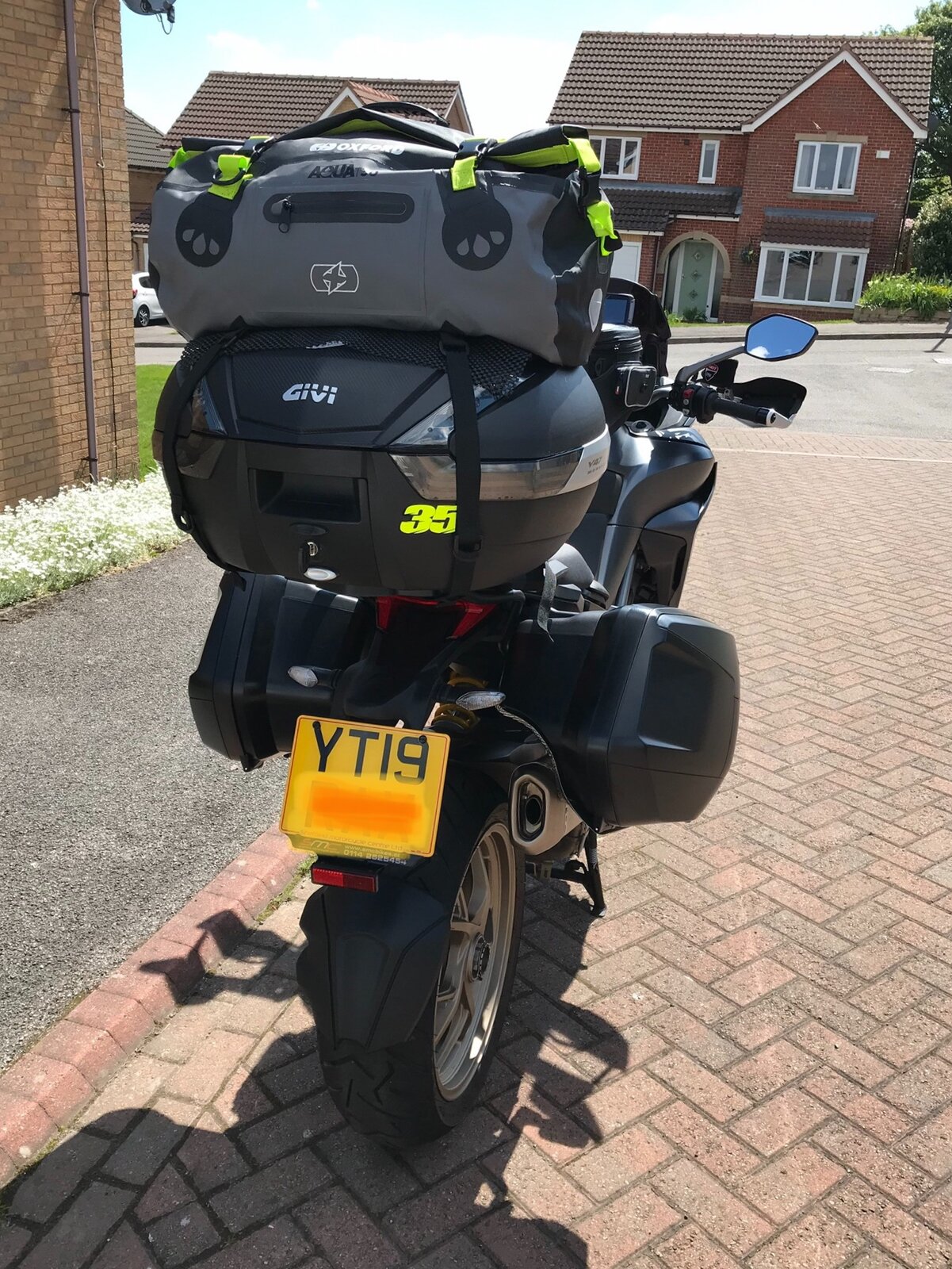

I have the full termi system, 1200 mile round trip to Le Mans this year no issues with heat or fouling the panniers, however I believe that a different rear hanger was fitted with the exhaust.

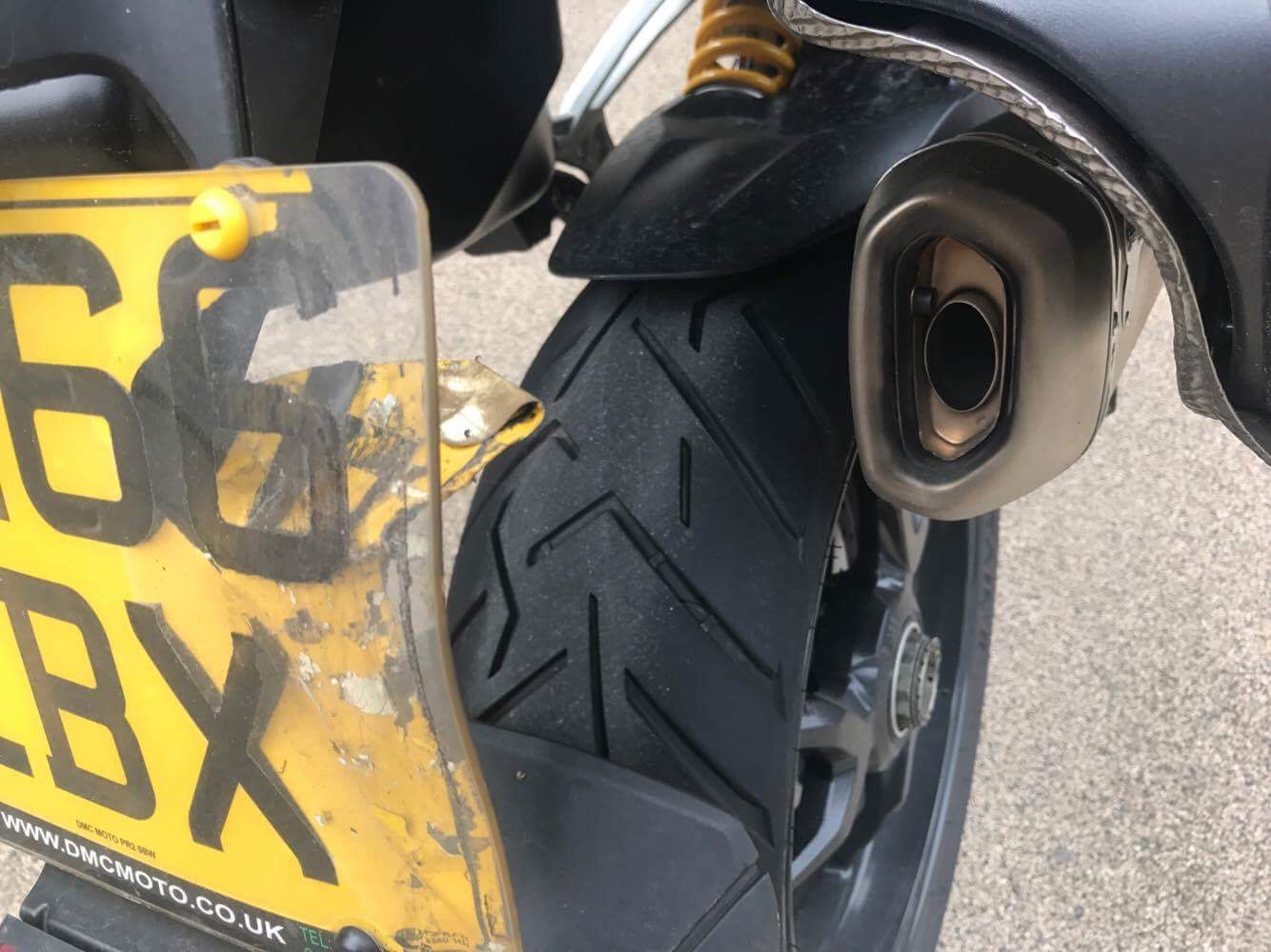

I have full system on 1260 PP. Panniers fit with no issues. I’d use the db killer though as I fried a standard number plate on my 1200S multi through Germany. Didn’t have an issue in UK but being at 120+ for a while just melted it. The db killer was enough to deflect the heat away and stop it getting worse. Got a smaller plate when I replaced and no probs after that.
Hello, I have a full Termi system too and standard panniers fitted - no problems at all. Two months ago went on a 2,000+ miles trip through Europe, no problems at all. Hardly reached 120mph however with no db killer fitted had no issues with the plate (but you can see the back of the plate is no more white if compared to the left hand side bit).
