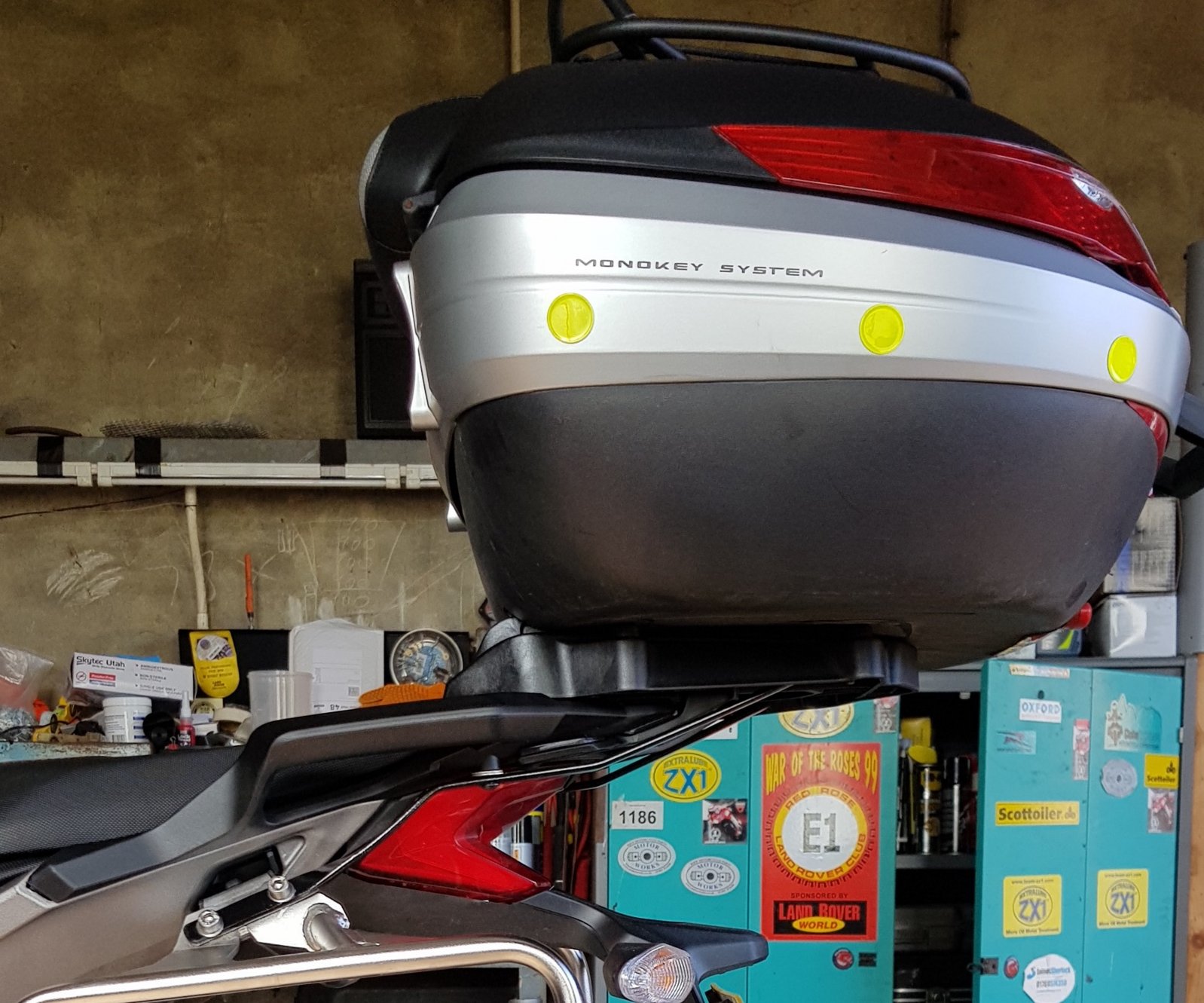

  8. Were the Givi mounts you found for the top box or the side panniers. I have the Enduro with the Ducati branded touratech panniers and I'd like to fit the Givi monokey top box that I have on my other bike has but cannot find a compatible mounting kit.

    Update about the above. I spoke to my local dealer who made some enquiries and supplied all the brackets required to fit the Givi mount.
    Whilst it all seemed straight forward there is one single problem. The touratech frames have a cross brace which is in line with the supports from the top box mounting plate. The touratech top box support braces are shaped differently from the Givi ones to avoid this, unfortunately they don't match to the Givi top plate, so basically you can't mix and match touratech panniers with Givi top box using OEM fittings. At least you can't just now.
    The (quick) answer came by the way of some flat bar, paint and longer bolts.
