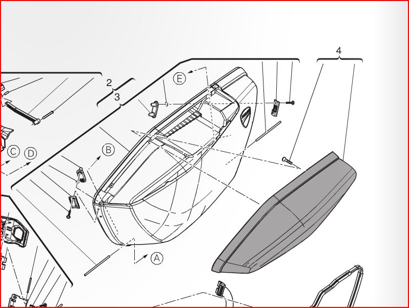

  2. I haven't tried to remove them myself but I took a look at the workshop manual and found this diagram:
    It looks to me that there are no other fittings/screws to be removed so the cover must be held in place by lugs which should mean it will slide off (away from the screw fixings) with a bit of gentle persuasion? I'm sure someone on here will have already done it if you want to wait for a definitive answer though.

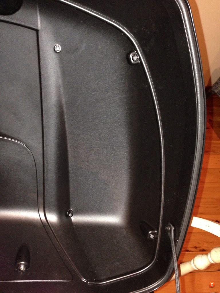

  8. On my ducati top box just unscrewed the four small screws for each panel and they lifted off. [​IMG]
  9. There are screws hidden under the rubber seal.
  10. Sorry I thought you were referring to the top box. Side panniers. Would agree with tripletrouble
  11. There are 2 inside the lid that are visible and three smaller screws under the rubber seal
