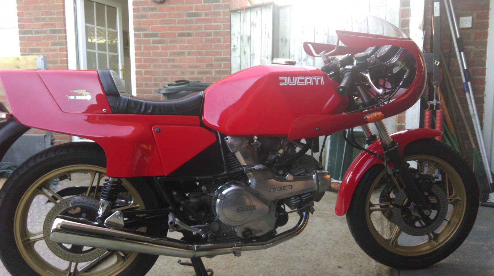

  16. Pics as promised. All road legal now and going well.....but!...... Is 80lbs/Sq.in too much oil pressure?
    Seems a bit much to me.
  17. The workshop manual says:
    "With the engine warm at 4,000 rpm (or more) the oil pressure should be 5.5 - 6.5 Kg/sq cm."
    You'll have to convert that into lbs/sq in yourself!
  18. 78.2 to just over 92 psi ;-)
  19. Thanks lads. It would appear I worry too much! Someone`s had fun in the past because there`s an oil pressure gauge fitted, and not a cheap affair, a nice liquid filled one with a nice braided pipe. So I was thinking the worst. It wouldn`t occur to me to fit one just for the hell of it to a road bike so that`s what got me concerned.
    (love this bike)!!
    Cheers fellas.
