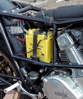

  3. I restored a 500SL Pantah a few years ago and used a MotoBatt MBTX14AU. I had no problems fitting it. Battery.jpg
