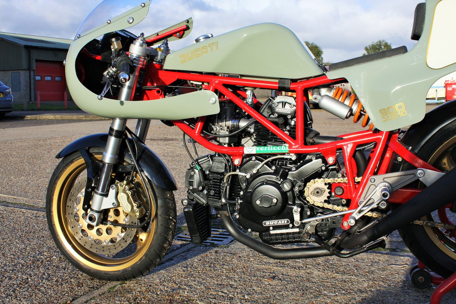

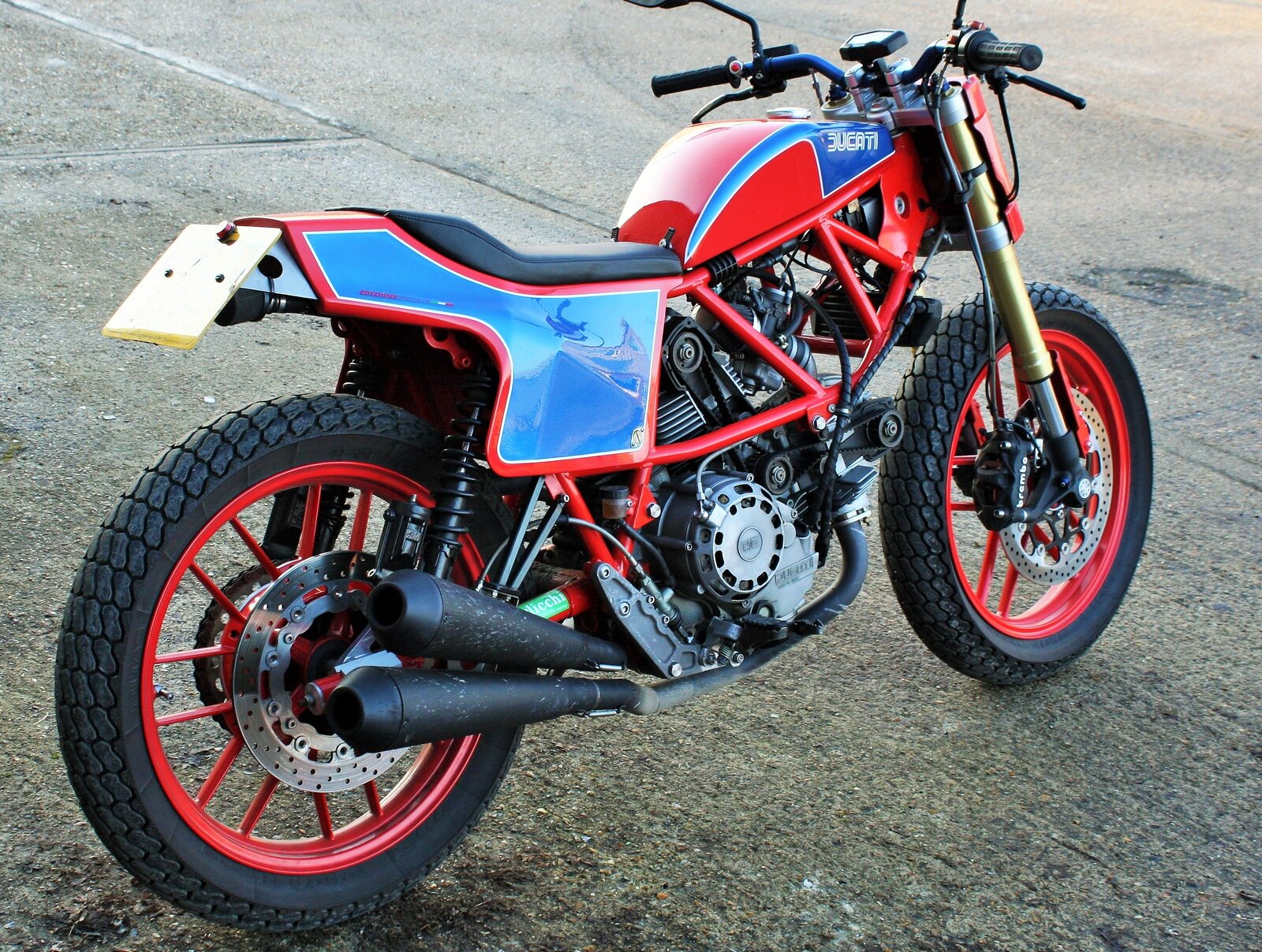

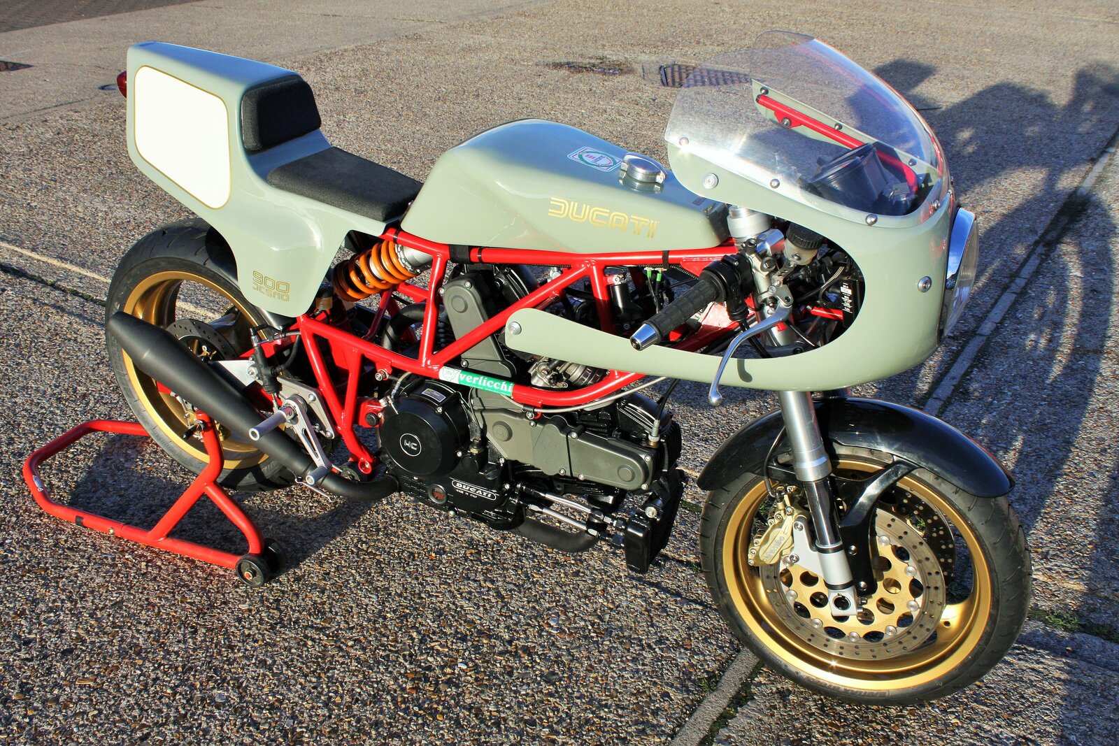

Here's my Pantah with a 900 engine, good idea running the later ie engine that doesn't have the oil return lines, it's a pain to get around (second pictures shows adapter required). I've fired it up but have been too busy to get it dialled in, I'm running stock ignition and PHM40's.
If you need an ignition unit holder there is one made for the RG500 in aluminium that's only £20 new https://www.performancefab.co.uk/ignitech-mount-bracket
Hi CJBarber Lovely bike. May i ask about the fuel tank? Is it home made or came from a manufacturer? Thank you Filippo
