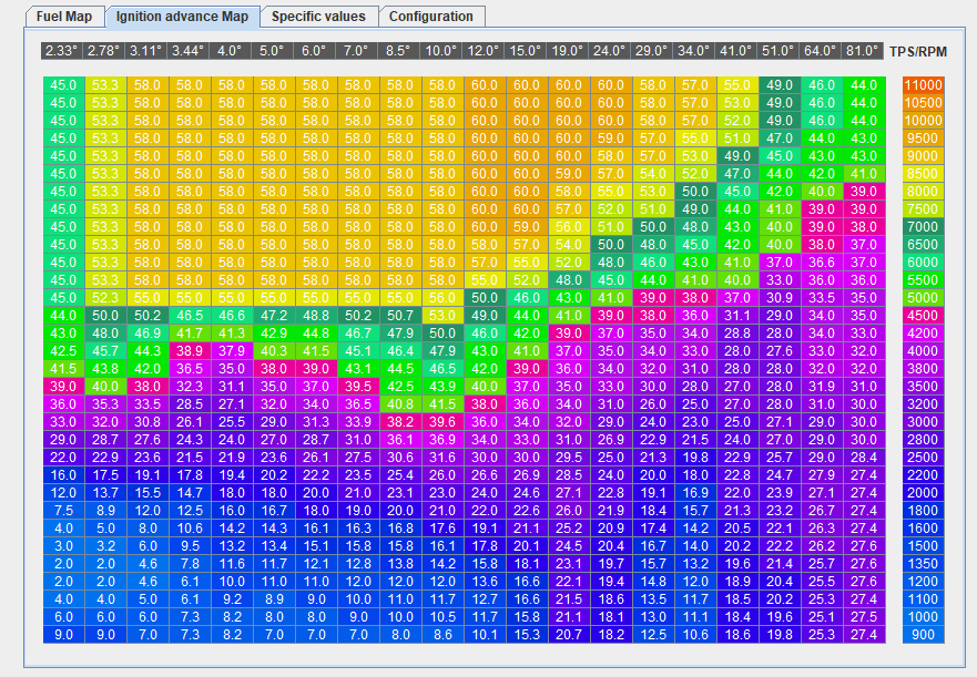

Bit of a geeky thing I guess but I've got both the OEM and Ducati Performance (57mm full system) maps available for the 999S (5AM ECU) and was wondering which one I should start with as a baseline to then do a custom Power Commander tune. At this point most people are thinking "it doesn't matter, the PC3 tune will sort it out" BUT the Ducati Performance map also has ignition curve changes vs the OEM map. Here's a comparison of the DP ignition curve vs the OEM one: In fairness I only have the 54mm system but with a decat on the horizontal pipe, hence why I wanted a full custom PC3 tune. Question still remains, which ignition map should I go with ?
Get the PC111 map done on the DP map. Take a USB with you and ask the tuner to put the custom map file on to it for ‘safe keeping’. Invest in TuneECU for Android. Dump the DP map using TuneECU. Load the PC111 into TuneECU off your USB. Overlay the PC111 map onto the DP map using the tool to do this in TuneECU. Save this hybrid map. Upload the hybrid map to your IAW5AM ECU. Now remove the PC111. If you do not need the PC111 then sell it to pay for the custom tune.
