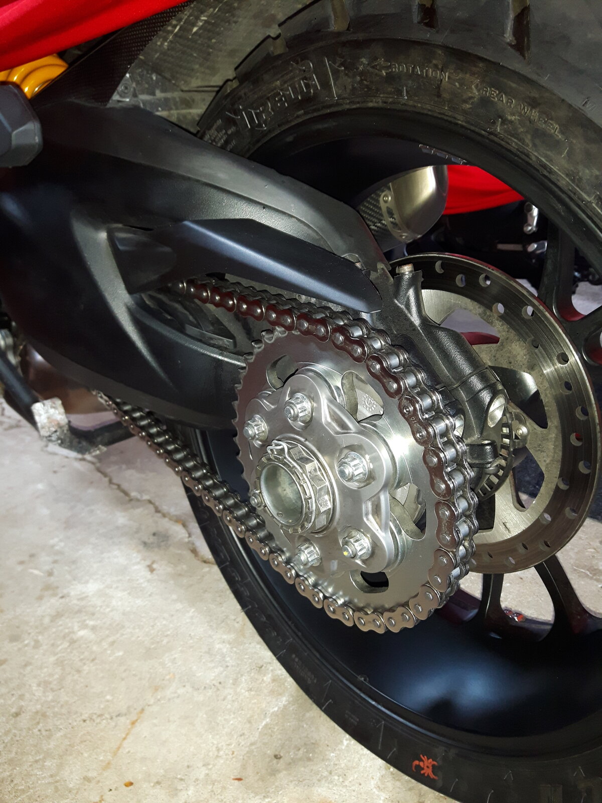

  4. Modern quality chains are internally filled with grease.
    All they require is regular cleaning to remove abrasive road grit after every ride day.
    A light coat of motor oil thereafter serves only to prevent corrosion.
    This is what your chain should look like even with 17,000 kms on it.
    Btw, It's tension has never been tightened as it's still within specs.
