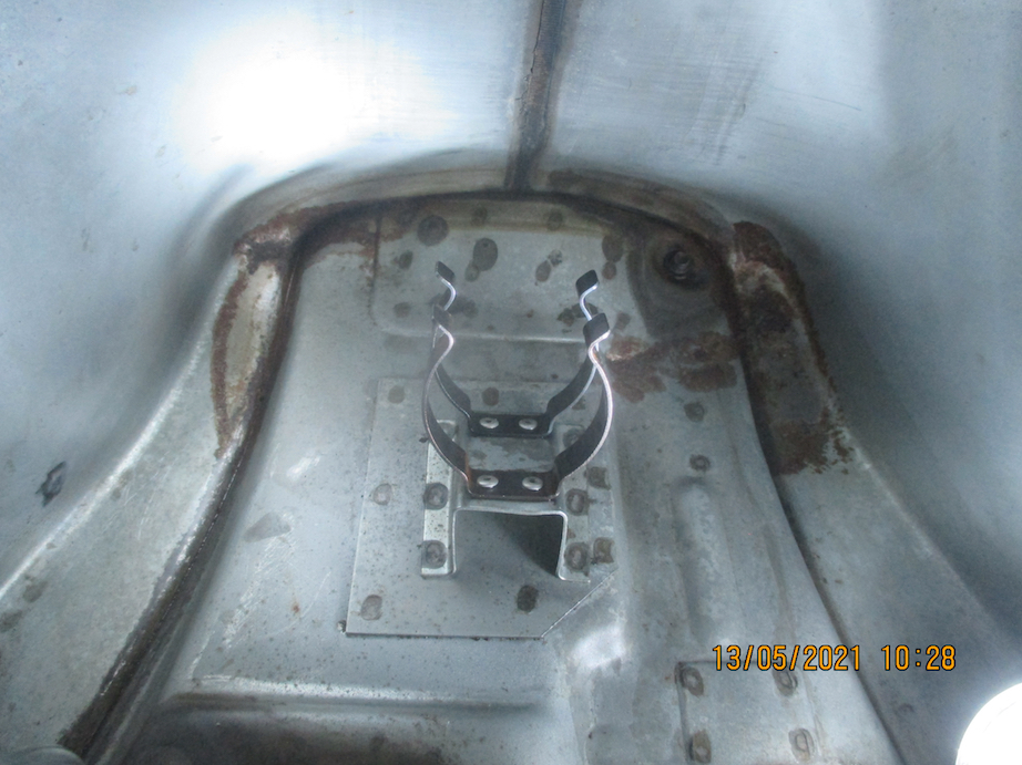

  1. My SS has some surface rust starting in the usual places (lowest points at the rear) and I would like to coat it with something before it gets any worse.
    I know a few people have on here have used this stuff; POR-15 Motorcycle / Bike Fuel Tank Repair Sealer Kit, but can't find any reports back about longer term use or problems. Can anyone give any information after having used it for a significant length of time?
    It would seem sensible jut to coat the lower rear part of the tank but I don't know if the fuel would attack at the edge and get behind the coating after some time.

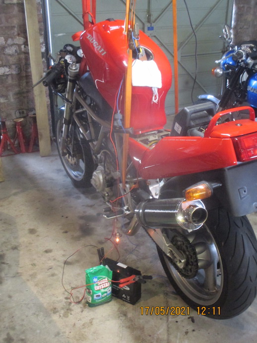

  3. I have used electrolysis to de-rust the inside of tanks to good effect. The tank is a natural container so you just need some soda crystals, a battery charger and a steel rod/bar with an insulating collar.
    This may not be the best tutorial out there, but it gives the idea. Polarity is crucial when connecting or you put rust into the tank!
    https://www.instructables.com/Electrolytic-Rust-Removal-From-A-Motorcycle-Gas-Ta/

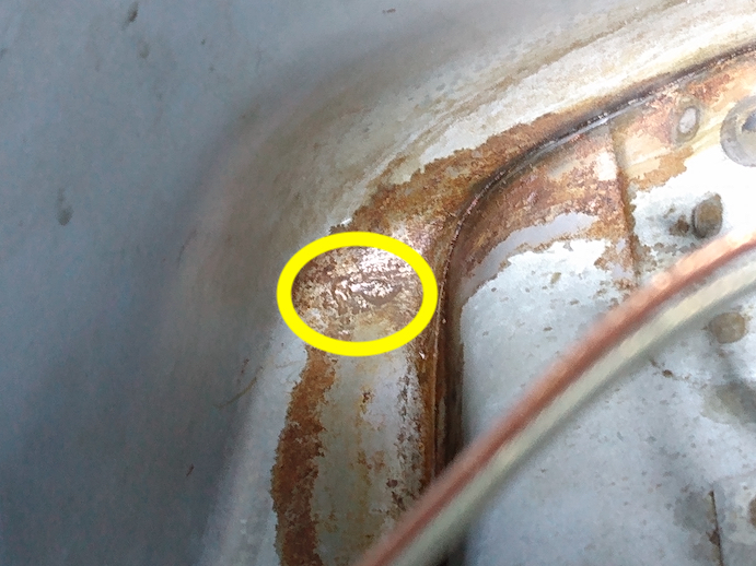

  4. The problem is it is starting to pit at a couple of bits so the metal is already thinned. The worst bit is at the left hand corner, in the picture. I want to try and stop it getting any worse.
    Iv'e used electrolysis a lot over the years and may do the tank just to completely remove all the rust, then decide what to do. I think all our petrol in Scotland comes from the same place and it all has the dreaded ethanol in it which only makes things worse :(. For twenty years I have drained and oiled the tank over the winters and any years the bike was not used so I guess it is not as bad as it could have been.
    I'm certainly not going to start welding in new metal, yet - that is for fixing holes.

  8. Jack, I havent done electrolysis on a (modern) ducati tank. Personally I would remove all filters/pumps/level sensors first. Maybe make up a dummy sealing plate if that is easier. On my tanks I removed the fuel taps and sealed the holes with a threaded bolt and fibre washer. Generally the caustic soda solution doesn't aggressively attack paint, but I would wipe off any spills to be safe.

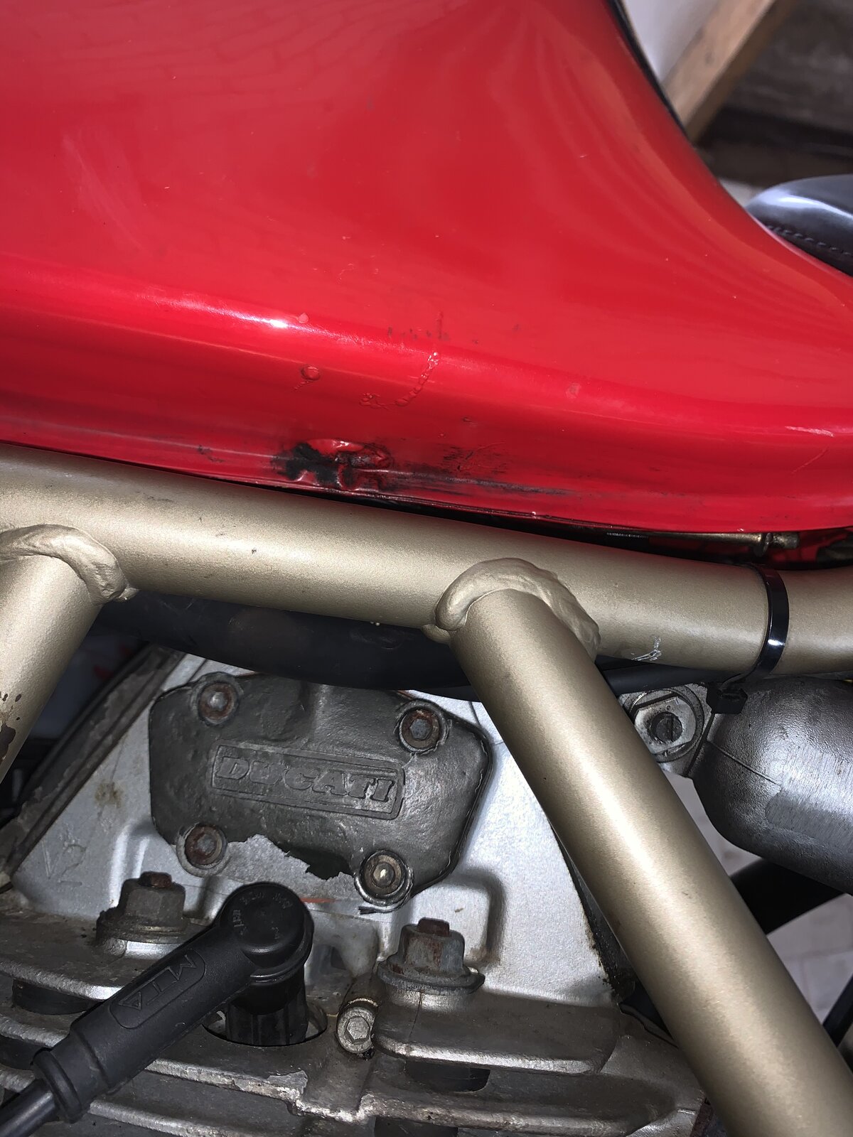

    Mine perforated at the usual spot and started leaking
    Had the guys at Ducati Mcr fix it and re spray it afterwards, looks as good new now.
    Only downside to using Por 15 was it blocked the air breather spout on top of the tank causing it to stall after a few miles.
    Once cleared it’s now fine.

    I have had a bit of a scrape about in the tank and there is only one bit that is anything more than basically stained metal. Strangely it is on the right hand side of the tank (left in the picture, as before) and not the lowest point when on the side stand - might have been a contaminate in/on the metal when it was rolled or stamped.

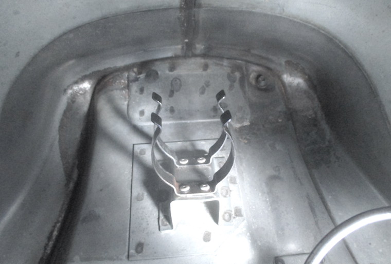

  15. Well, I did a bit of electrolysis on the lower rear of the tank. Cleaned up quite well with only the one small area that looks to be in any way concerning.
    Tank is now all back together and oiled up again. I am probably going to put the bike on the road next month and at the end of the summer will look at coating the tank - should give me time to gather more information on the products available.

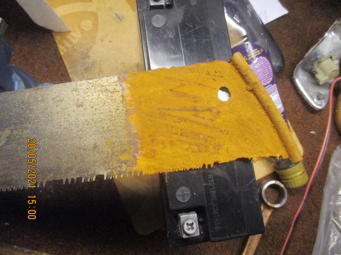

  17. I siphoned the bulk of it out, wiped most of the residue out with cloths then scrubbed with hot water and Fairy Liquid (other brands are available!). Used a heat gun to gently dry the tank afterwards. I only did the rear lower part which made it easier.
    Here is the remnants of the saw blade I used in the electrolysis process:
