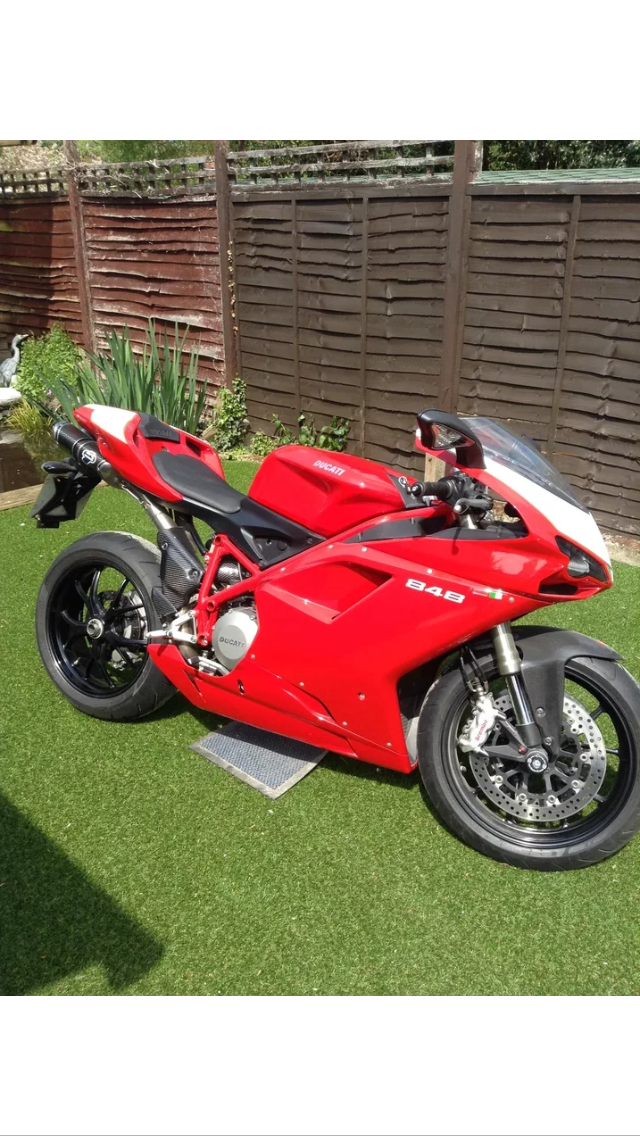

  1. Evening all, well I'm about to hopefully buy and pick up my dream bike I've wanted since they came out on Saturday and was wondering if anyone had anything I should look out for other than the obvious. I am mechanically minded but only on Jap bikes.

  2. I would say just don't let any little problem 'develop' and you will be fine, just keep on top of making sure that furry electrical connectors etc are clean but overall they are fine. I had an issue where my Fuel pump relay failed because it had corroded, they sit behind the battery and are easy to soak when washing the bike and then they fail. and if it's an early bike, make sure it's had the radiator replaced under warranty as they had some issues with leaking radiators.
    Got any pics? I had a 2013 848 Evo and enjoyed it a lot when I wasn't commuting!
  3. Appreciate the reply, right o I'd read about some electrical issue so I'll have a look at them when I'm there.
    It's a 2010 model non evo but I've already got my damper sorted and the guy has some monoblocks I'm thinking of having off him so couldn't warrant the extra grand and half for evo model myself.
    Thanks pal.

    Get the monoblocks or buy some 4 pad radial callipers as fitted to 749/999R and RSV's (much cheaper) as the original 848 brakes are pretty wooden.
    Spooky that you got a bike that matches your name...some kind of destiny stuff going on there....
  5. it's got slash mount Termis' which is great, and tbh some people prefer the standard 848 on the road, it's a less 'top end' engine. The essential mods mate are 14t front sprocket, and a clutch slave cylinder such as Oberon, and perhaps a grippy seat as you slide around a lot on those standard ones!
    Honestly I would bother with the brake upgrade, yes the Evo's brakes are unbelievable but a good bleed and some decent pads and those calipers will be fine. Best of luck

    Thanks, I hope it looks as good in person as the picture does, suppose to be mint. Was planning on riding it home but I don't think it's suppose to stop raining all weekend so picking up in van sadly :(
