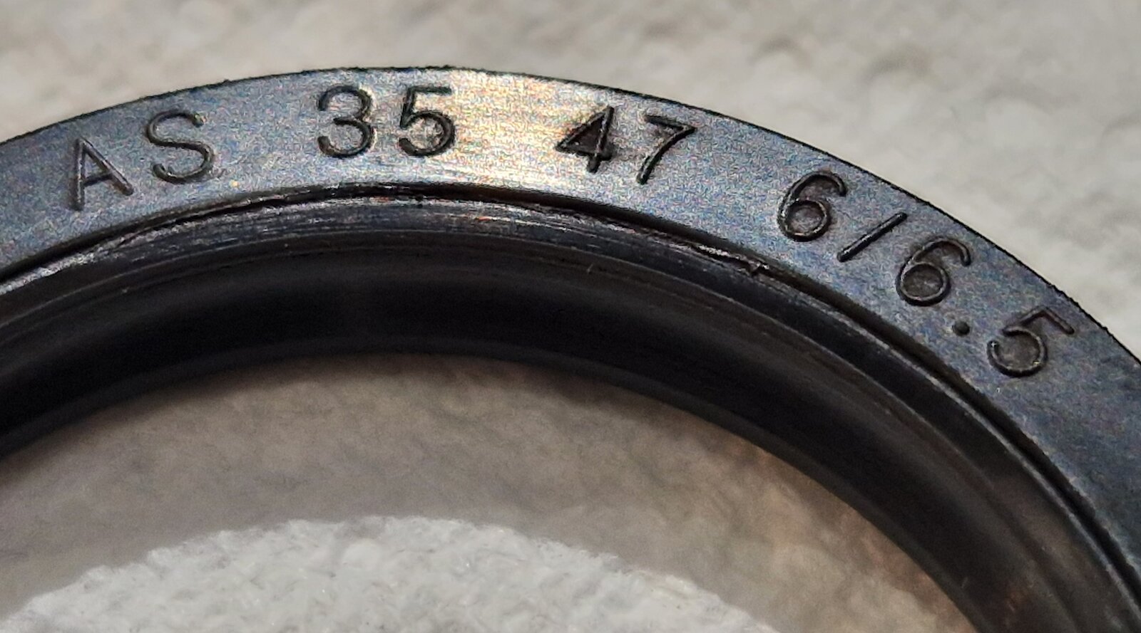

    And yes, the seals have all the dimensions on them, as does the Ducati parts diagram.

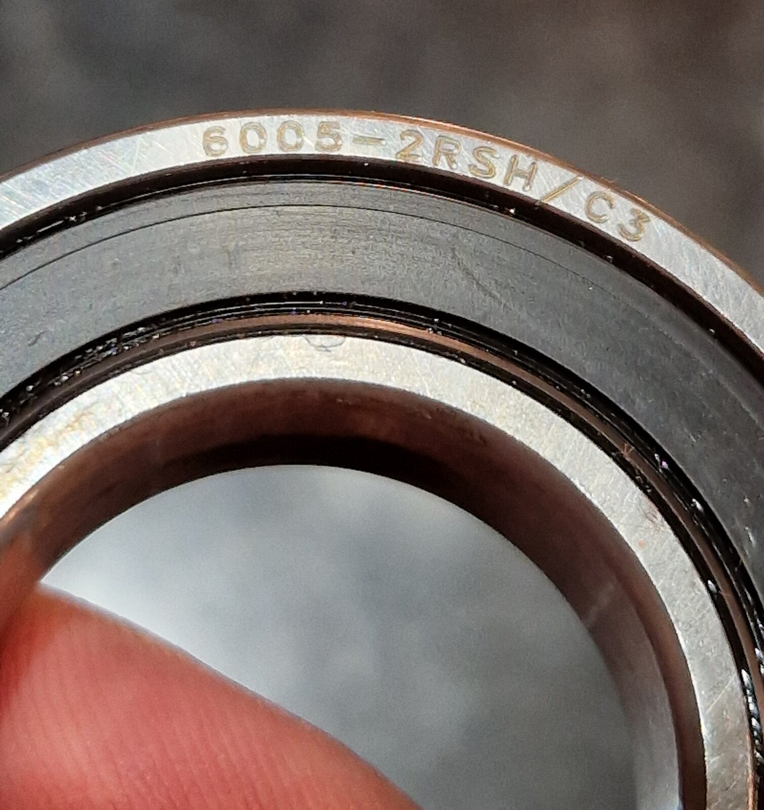

  8. Popped the seal out on the opposite side.
    Not fully legible but I'm reading that as 6005 - 2R SH / C3. On a search this brings up bearings that seem to match what I need. @Macca, you were correct:upyeah:
    Seals have AS 35 47 6/6.5 clearly marked.
    Looks like I have the information I need. Now to find a local supplier.

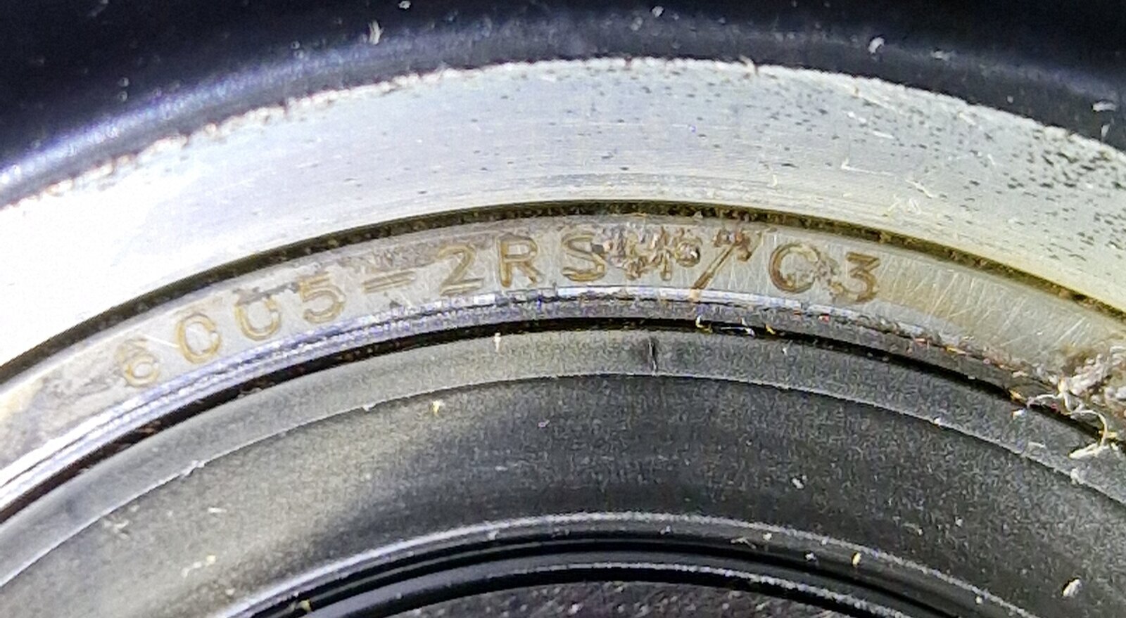

  10. Bearings ordered along with new seals. Seals more expensive than Ducati ones but bearings a lot cheaper for SKF. And they'll be available to collect tomorrow morning.
    I've now taken the old bearings out and reverse of knackered one confirms the SKF part number/specification.
