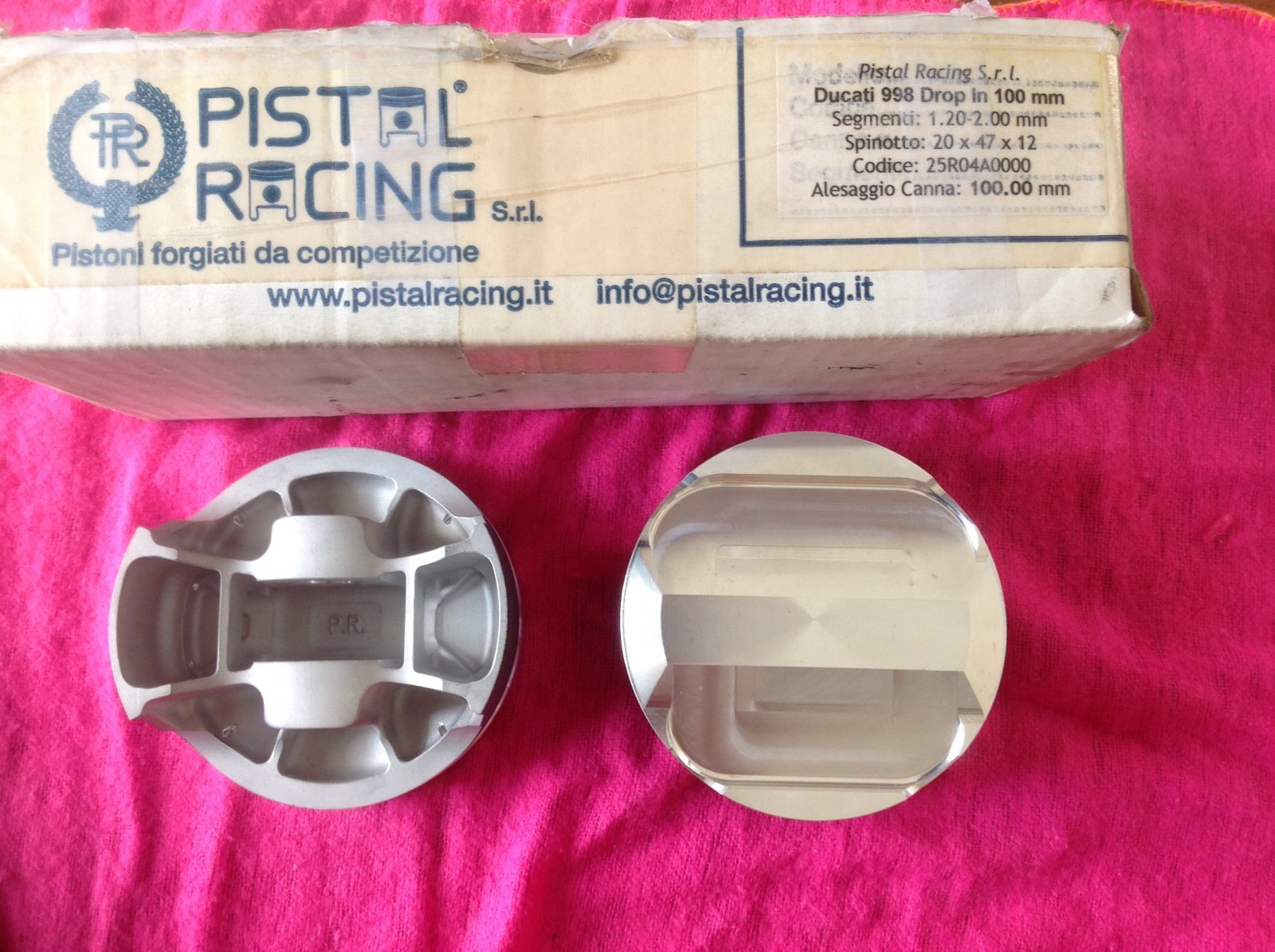

  1. Hi I had a vertical belt fail which has bent a couple of valves gutted but it could have been a lot worse so while the engine is in bits do I fit some new pistal pistons that I got a while ago if so does that mean that the engine would need to be balanced ?
    And are they worth the extra expense ,would I really gain anything ?
    they look like original Pistons not the HC racing items and do say "drop in " but not so sure

  2. Presumably (if valves damaged) then your piston(s) is beyond use anyway? If so then rather than buy new OEM pistons use these.
    Probably need to be splitting the cases anyway after a piston to valve collision, so balancing is not much more work at that stage and best done even with standard pistons, once apart?

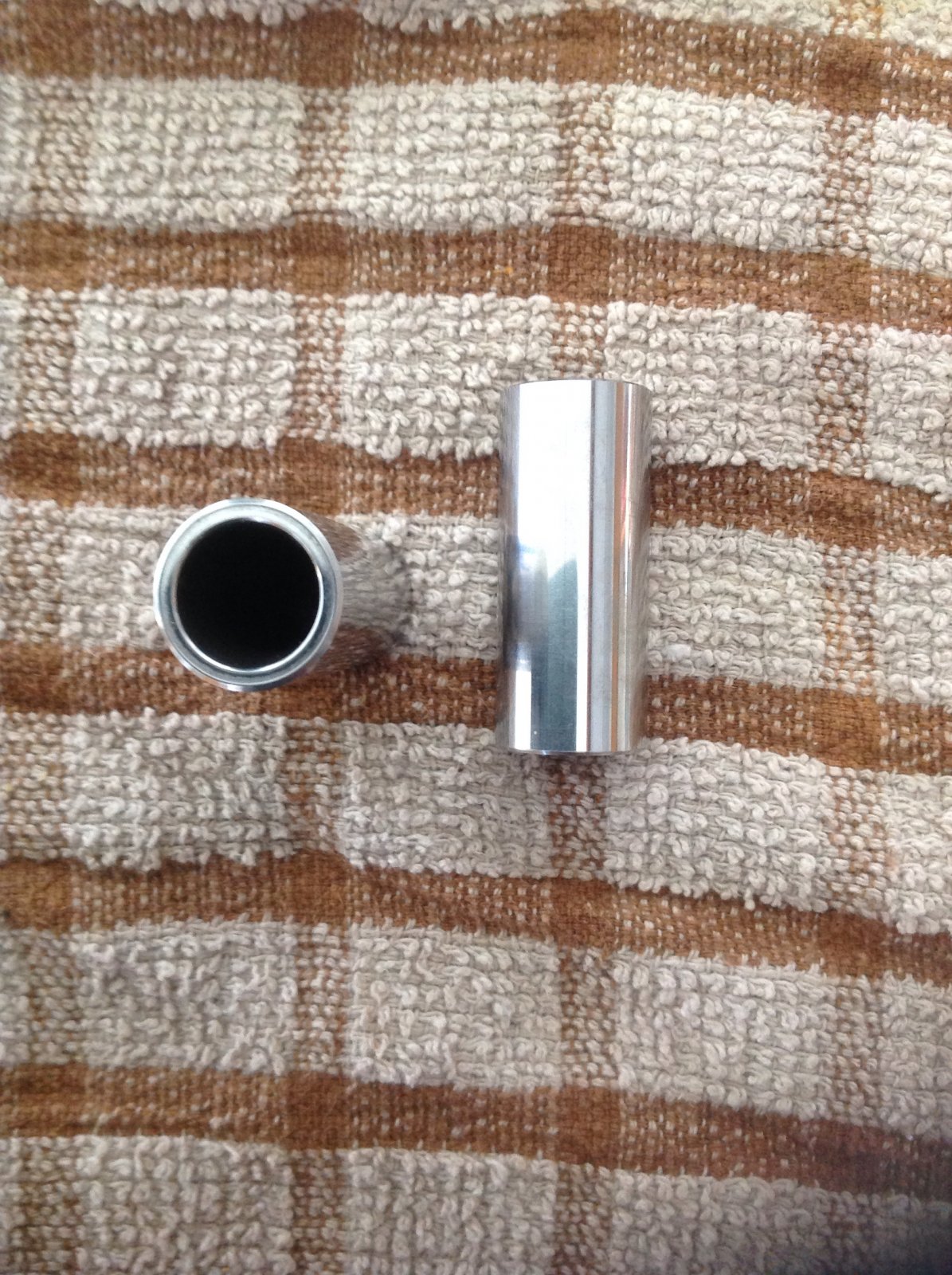

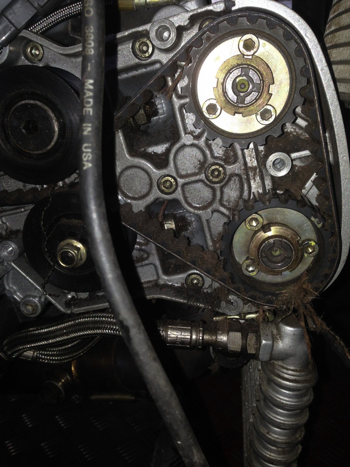

    Don t why it broke there was a ticking sound comming from engine then a small rumble and that was it image.jpeg
    The stuff that looks like grass is what's left of the vertical belt

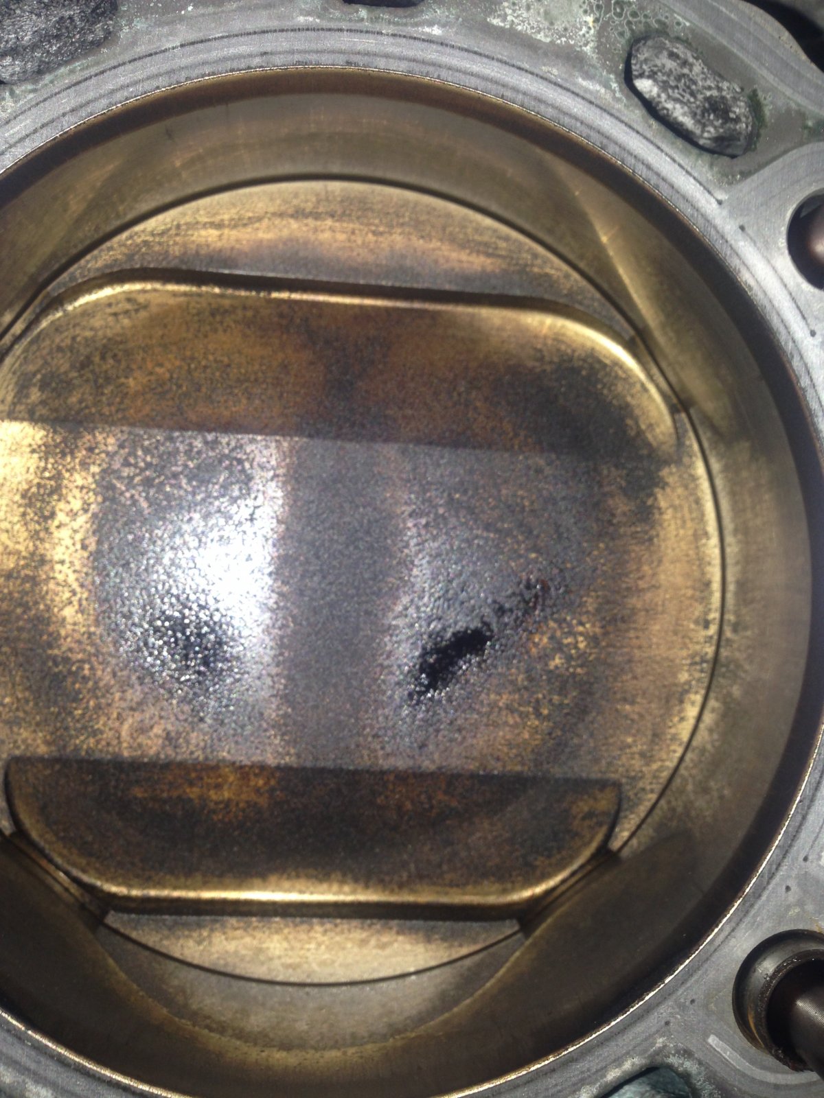

    This is the piston that kissed the valves , next the head is getting checked
    I was only going about 25-30mph
  15. If that's a hole in the piston and not just a black mark where is the metal
  16. It's just a mark
  17. But it's the piston speed that matters, not the road speed.
    That said, the piston looks OK but I'd still be wanting a good investigation at the bottom end.

  18. Looks to me that the belt tensioner was tightened the wrong way so the belt rubbed on itself. Who fitted them?
  19. luckily I was in Sunday traffic entering a town Pickering so I d say 3-4 rpm range so yes very lucky , would the slipper clutch help in this situation ?
    Belts fitted by a worker of a mate whom was sacked a while ago not a shop, my mate been a great help though
