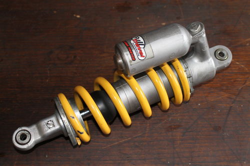

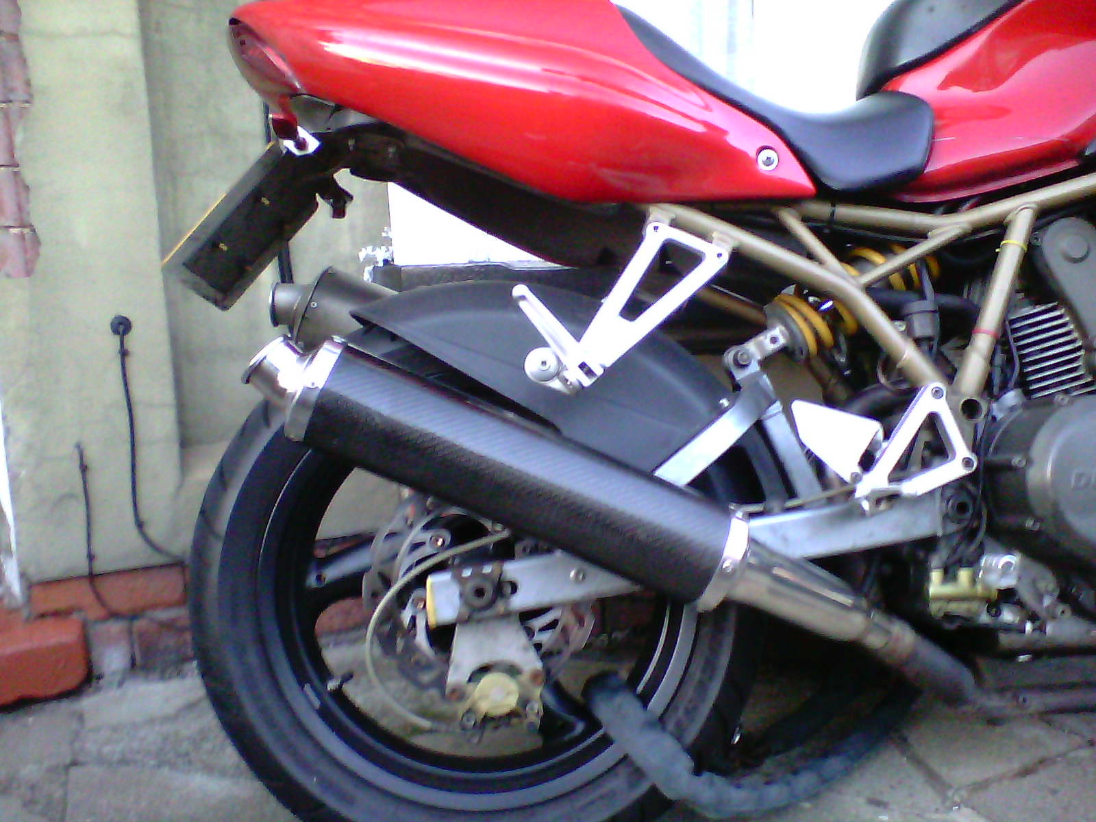

  6. This is advertised as for a 2002 900ss ie but it looks different to mine, which looks like the one on John Boy's bike image.jpg
    #6 Zhed46, Oct 4, 2015
  7. The first shock looks like the carb Showa type. The second is the one Ive seen for the Injection
  8. DQ, do you mean the one I posted looks like a late one, ie: the right one for my ie bike?
  9. The can end outlet is upside down to collect raindrops.....;)
    It's a Sachs Boge shock...........It may or may not be the right one for your bike....
    If it is an OEM one from a carbed SS it will be wrong......they are shorter than the IE shock.

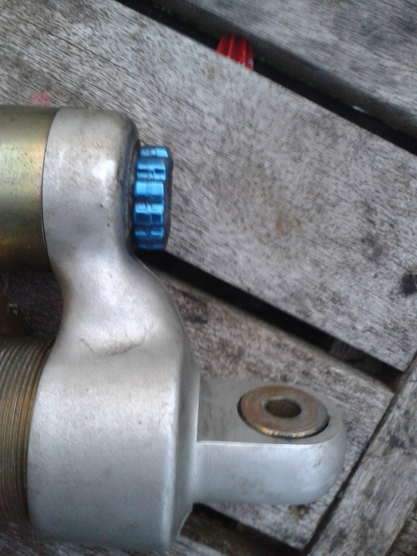

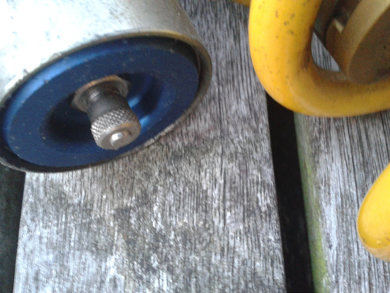

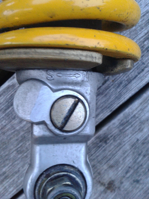

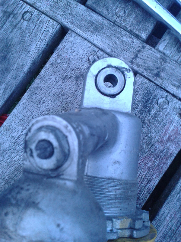

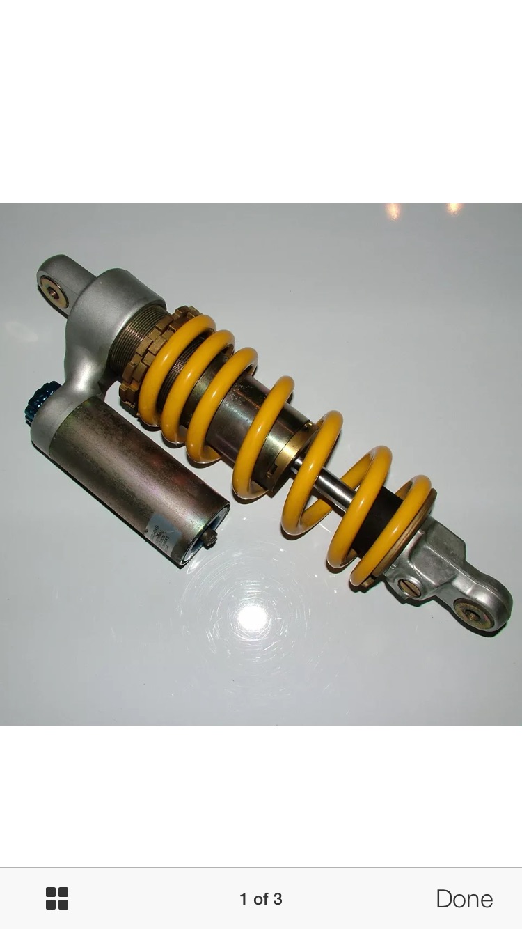

  10. ie shock this afternoon:
    Carb (pre ie) shock also this afternoon:
    The above shows you how to quickly determine the type.
    Regardless of which (ie or carb) model one has the later ie type is a better shock AND longer - which is what these bikes need.
    They're still too low for decent track use. If that becomes a problem then find a ride height adjustable unit. The Ohlins fitted to the SS1000 is good as are most known brands.
  11. Yeah that is an ie shock.

  12. That's fantastic AD. Exactly what I was looking for. Thanks

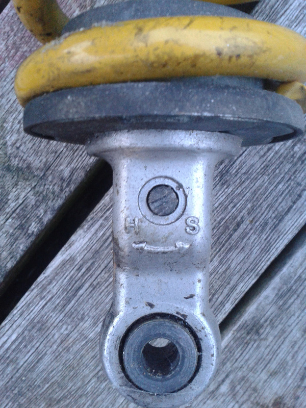

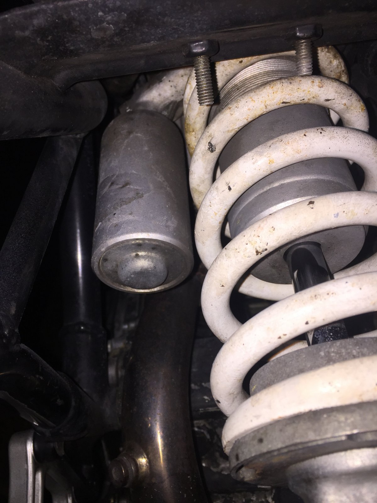

    It appears that my suspicions were correct and the one fitted to my bike is from a carby. Piccie below. Ignore the white spring. I have no idea why the wrong shock is fitted or what has been done to the suspension generally on this bike. The guy I bought it from told me the owner before him had had the suspension rebuilt. Well, if he did, he had it rebuilt in reinforced concrete as it was rock hard. I've backed everything off and made it a little more rideable but I'm just going to junk it and get a decent late model OE shock while I wait for a rare as rocking horse sh*t secondhand Ohlins to appear.
    Seriously though, there was so much poor quality work on this bike. For instance I've just spent this afternoon grinding a load of nasty random blobs of weld off the subframe and repainting it all.

  13. thought if it was pointing that way I could get more downforce on acceleration on the rear wheel
    ah so my shock is from a carby hmm bought as an ie shock
    was identical to the one I took off but then again my bike is a 1999 model which is mix and match from the factory lol
