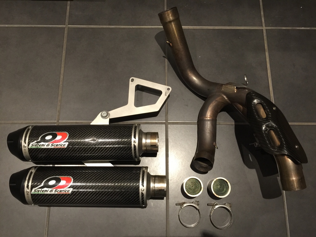

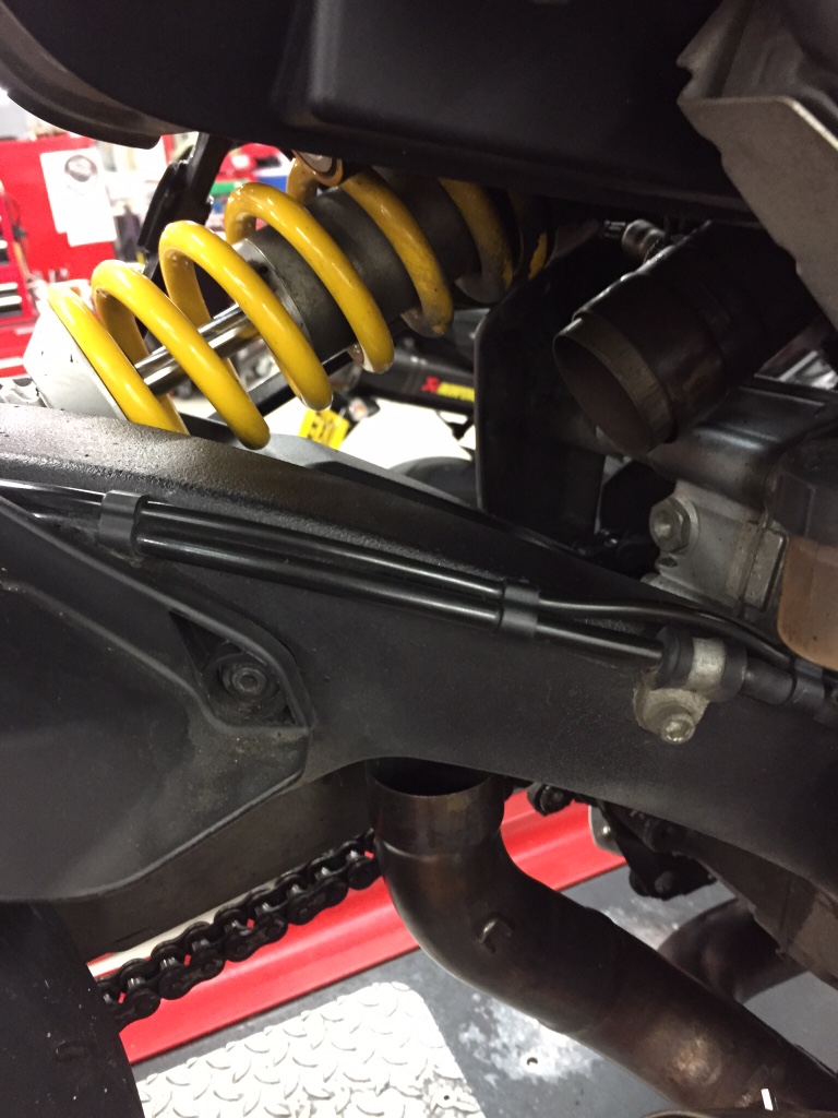

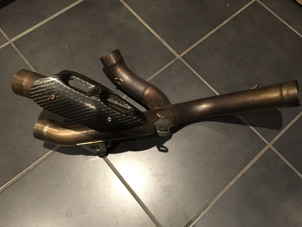

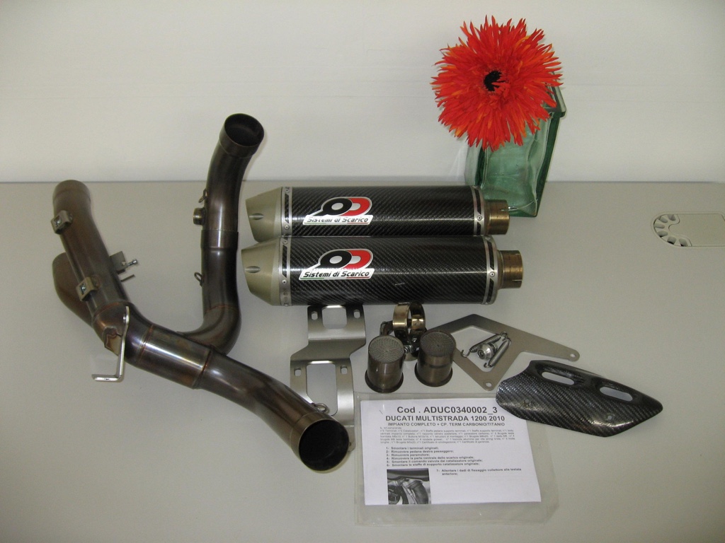

  4. Yeah....there are actually 2 parts to the piping...the main part, and a smaller rear part that passes through the swing arm. I'm trying to get hold of that part from QD Italy...
    Here's a picture of the full set of pipes, etc. [​IMG]
    And the gap....
  5. If you look at the full set very carefully, you can see the small link pipe...
  6. I stand corrected!
    It was 2 years ago!
  7. Yes, same applies to us all... I was convinced it was a single pipe....mechanic too... Well. Here's hoping QD can sort me out (and Steve).
  8. Stupid question, but you don't use any of your original exhaust do you? Just wondering if that little piece is part of the original system.
  9. Yes you do... The front and rear header pipes... It's not a completely "full" system, more a 3/4... It keeps the pipes which hold the lambda sensors.
  10. Ah, so you are missing that little pipe then.
  11. Yeah....sadly.
  12. Yeah, sorry to say DD you do need the little pipe extension that goes through the swinging arm and connects to the original rear header pipe
