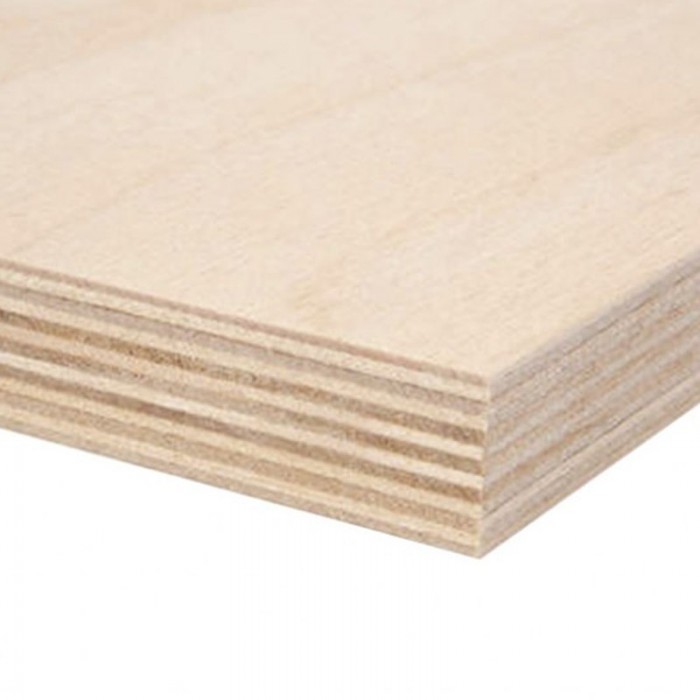

  10. Thanks all
    Petsmith, I've actually been recommended FSC Birch S+/BB Grade by a local supplier, so you've confirmed that, thanks.
  11. Glad to be of service
