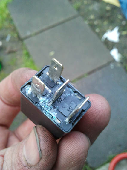

    Well, it was still pretty cr@p so I decided to have a look at a few other odds and ends. I have had a slow rev needle for a while and have been going over the electrical connectors etc and found the fuel pump relay had a small bit of corrosion which kind of explained why it refused to prime a few times since last autumn. The other day I thought "I still havent found the headlight relay" and like all niggles, resistance is futile!
    What did I find?? This!
    Ive just got back from a quick blast to test a few other things ive been fettling and I noticed that the lights were actually illuminating street signs and car number plates for a change. When I pulled into the garage I noticed the colour of the light has changed from a dull orange to a bright, slightly golden white light.
    What a difference a five quid relay makes! I just have to wait for a bit of favourable weather now so I can test it and set the angle of dangle.
    So, if your headlights are rubbish, yes it may be the angle but dont neglect the relay as in my case it has made a huge difference. :biggrin:

  5. Where is the headlight relay? Anyone got a pic in situ?
  6. No photo feel. Remove black plastic tray from under nose cone and feel it inside with your hand.
  7. Hi Bloofoot, hows it going?
    No photos mate but if you remove the black plastic cover from beneath the front fairing and look up you will see the headlight unit. If you are looking at the front of the bike the relay is tucked up on the left-hand side and is secured to the headlight assembly/bucket by a rubber fixing. Its the lowest thing on the left and is a small black rectangular gizmo. Its kind of below where the fuses are on the Right-hand side (sitting on the bike) but on the inside.
    Remove it from the rubber fixing and pull the relay out (make sure the ignition is off) and have a look.
    The newer relays are sealed while the originals allow water into the relay and go bad.
    If your having a play its worth checking the fuel pump relay too but that one is a bit harder to get at as it involves removing the battery box. At the end of the day the relays cost 4.90 each and can be the difference between a breakdown or a great ride.

    One little tip I got from the helpful chap at JHP the other day was if you break down you can swap the relays over. I.e. if the fuel pump relay leaves you stranded you can drop the headlight one out and swap it. I hadnt thought of that and thought it was a good idea as long as you dont need headlights obviously :cool:
  12. Just so you know its the same relay as the fuel pump and that sits by the ECU behind the battery box (On a 999) and I recommend changing that every couple of years as 2 of the legs corroded off mine once.
  13. The timing of this thread was great, fuel pump relay failed this evening so I swapped it for the headlight relay to get home, cheers JC!

  17. Good tip of old, change for new relay, then buy a big rubber glove, cut the bigger finger off, fill it with Vaseline and show up the relay there. Then wrap it all up with electrical tape. That should hold it moist free. It was a recommended mod on Ducatisti.
  18. Di electric grease, I just use vasoline it keeps the moisture out and contacts clean.
