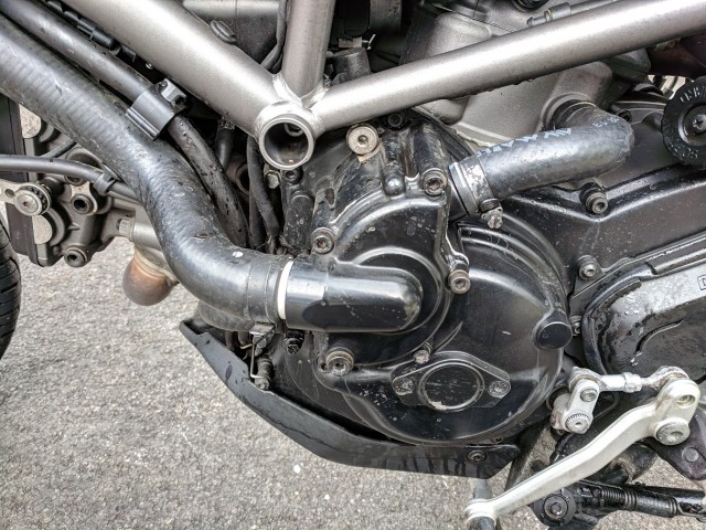

  1. Riding to work this morning, I notice that my gear leaver is slippy under boot - I assumed that I either trod in something, or the [new] boots just need a bit of scuffing up - so I drag on the road a few times and think nothing more.

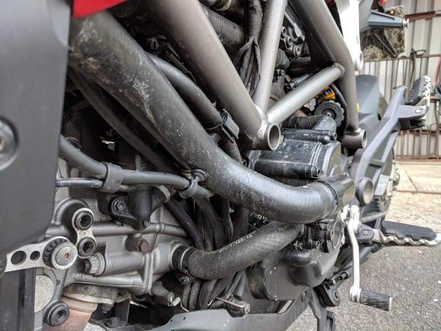

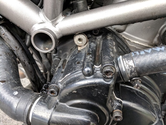

    Arrive at work and dismount, only to see fluid splatter along the left-hand side of the bike - thankfully not on the rear tyre though! First thoughts are 'b***ocks an oil leak!' but a quick dab and taste - it's red and sweet. Coolant!!

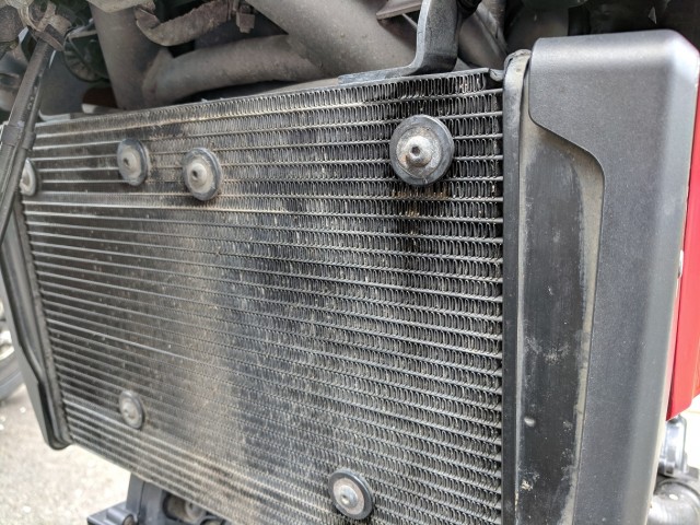

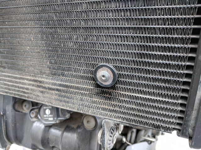

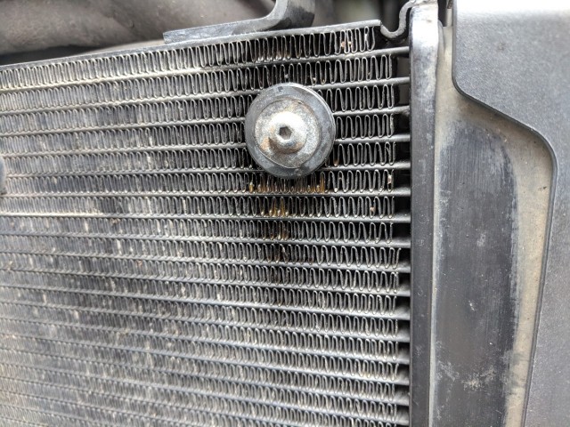

    Just took the side panel off and had a nose around, and the only thing that I can clearly see, is that the fan mounting points are weeping in the rad - mainly one of the top ones, as with the engine running; it appears to either bubble or dribble a very slight amount (enough to see).
    The fins of the rad look fine - no strikes at all, and ironically I was just about to purchase a rad guard!!!
    I'm wondering whether the mounting points have a bit of corrosion, and that has caused a leak in the rad - and that the air flowing through, has caused the splashback I now have. Though, it's a decent amount of drops along the side of the bike.
    Anyone had experience with rads at all - whether this is a fixable thing, or, well how to process from here really? I have a 15 mile ride home later, and although the temps aren't shooting up when running - I'm not sure whether to baby her home or call for recovery.

    Did a complete strip down of the cooling system, washed it all out with a hose and then sent the rad off for repair - a new rad was nearly £500 from Ducati, and the repair was £54; so I thought why not! Prior to sending it off though, I filled it with distilled water and pressurised it to 20psi - found a single jet of water was spraying from the top of the rad, just beneath the surround.
    A day later I picked the rad up - it looked like a bit of a ghetto fix, a bunch of epoxy stuffed into the offending area, and sprayed, but it did the trick!
    Touch wood, it's been all ok! The leak in the photos was misleading, as it was actually spraying/dribbling from the top.
