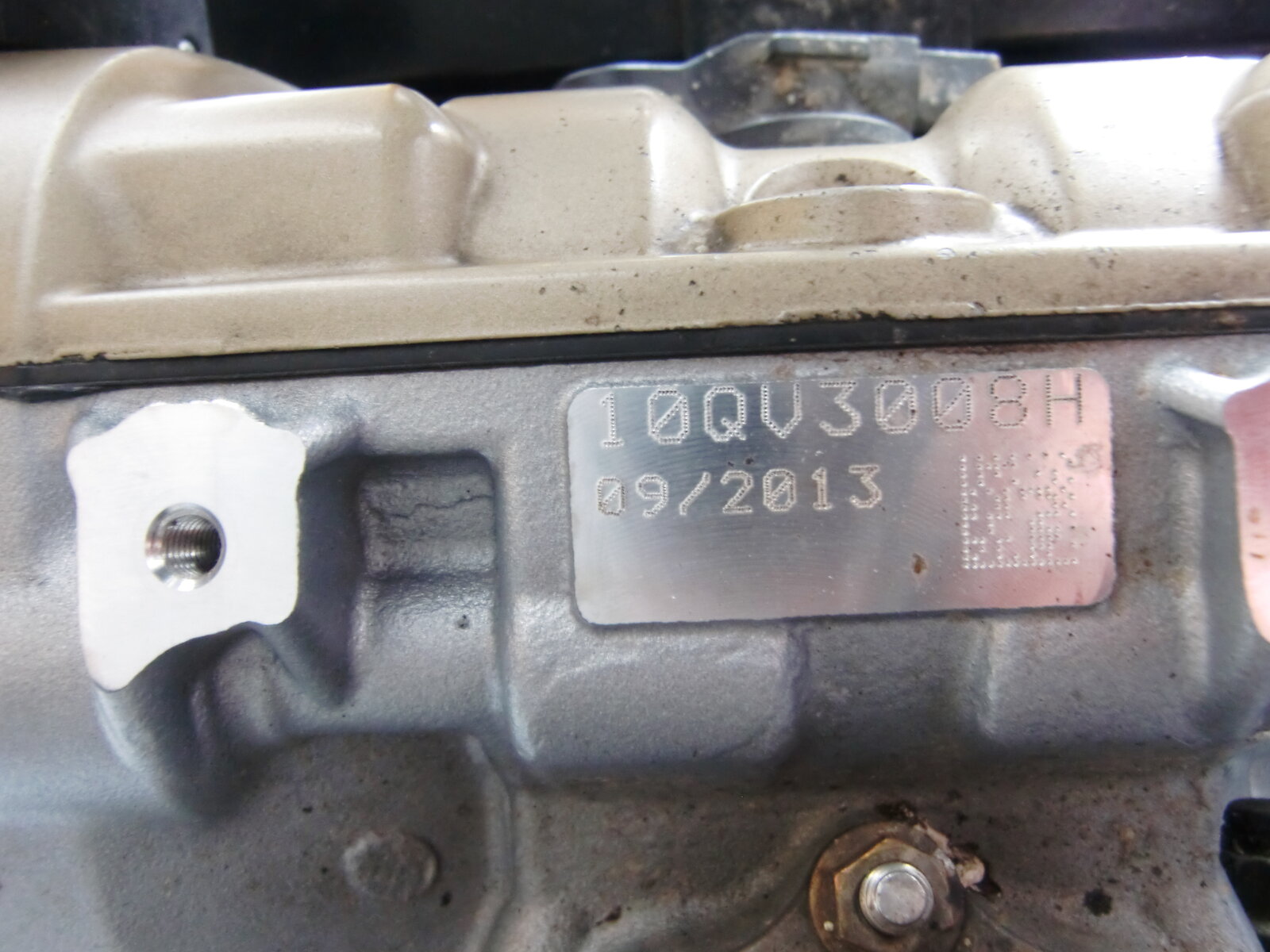

    Plus is there a way to check a prospective purchase bike that the heads have been replaced and not rely on the owners word for it?

  8. check, yes, the production date of the head is stamped next to the exhaust outlet
  9. This is perfect
