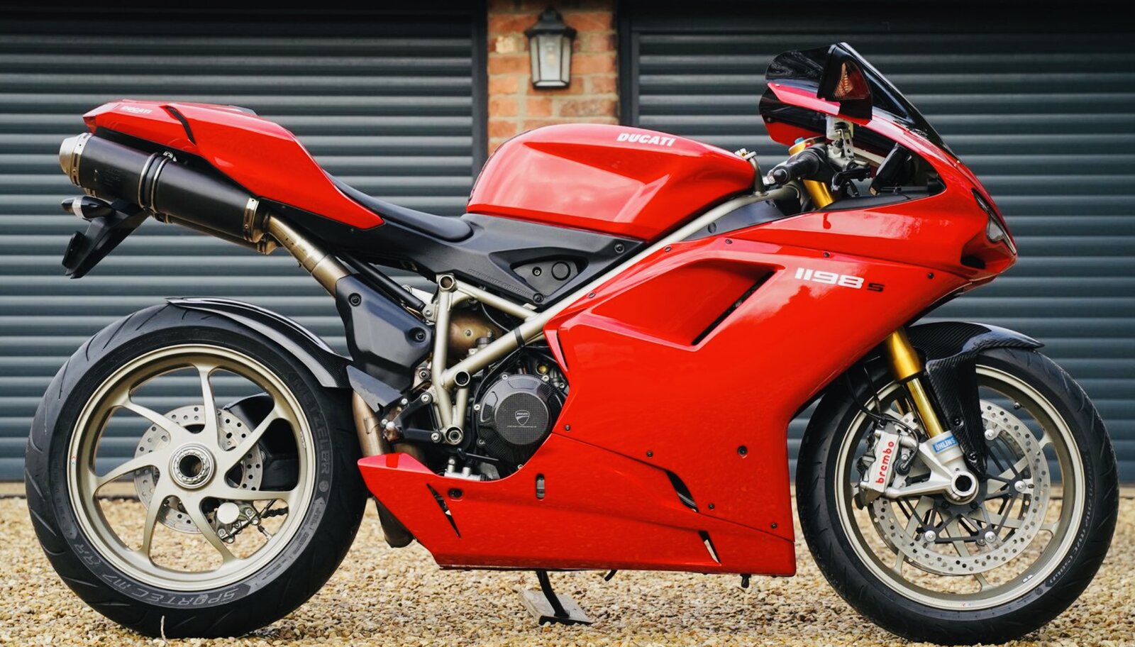

  6. Thanks for your input, low miles great condition and full history, couldn’t say no 6671CF13-C322-4942-8448-F566485785CA.jpeg

  7. phhWWOOOOOrhhhh mister!
  8. That's a hell of a sweet bike! Congrats mate, and enjoy.
    Are you going to go for after market pipes of some variety or another?
  9. Blimey. That is a bit nice. Fab bike. Well done pal.
