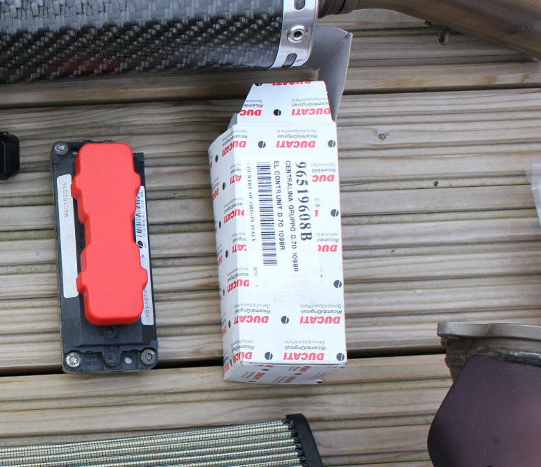

  13. the ECU he has is a 1098R part number (i guess they may have used the same for the 1198) and reads '0.70 1098R' ......so he has the ECU for the full system and it will display 'RACING' on the dash...I think he was stitched up

  15. He appears to have the ECU for a full 70mm system and he has the end cans but in between he has the OE pipes not the 70mm pipes.

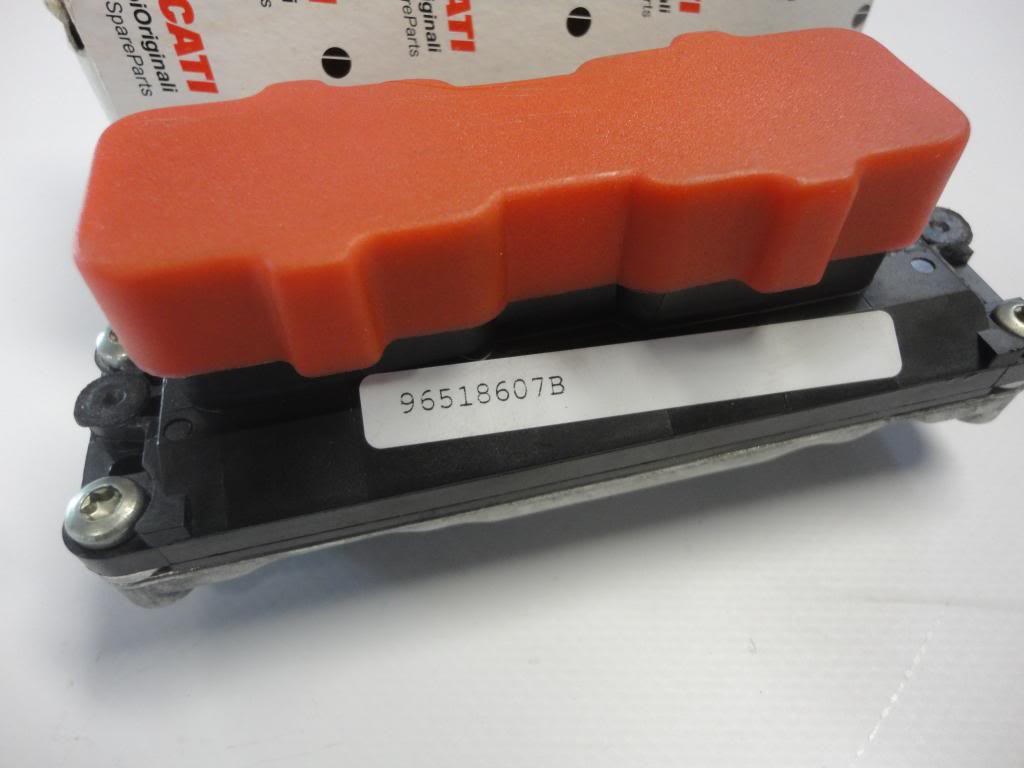

  17. Good spot slof. Hopefully this will prevent someone else getting ripped off :)
  18. 96519608B definitely ECU for a 70mm packing 1098R. Google 95618607B you get ECU for 1098/1098s. Andy
