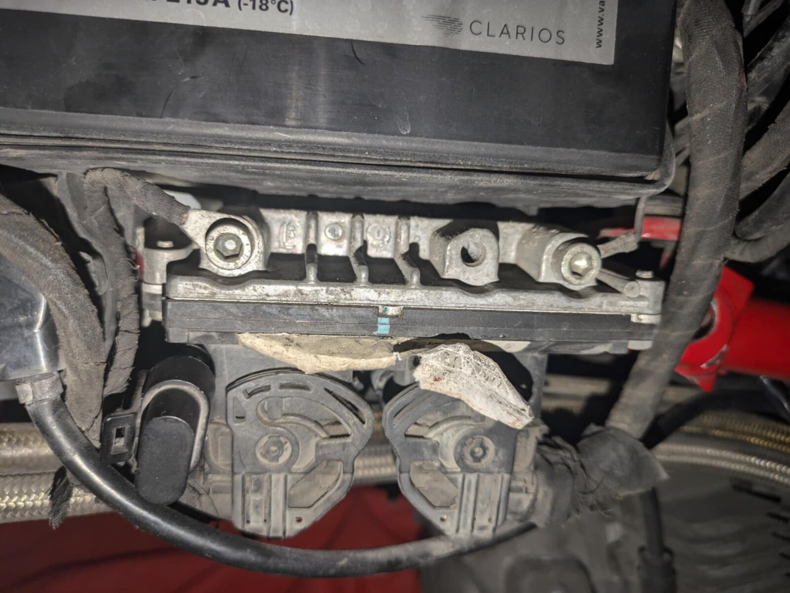

  1. I have an '04 MTS1000. I flashed a DP tune on it and saw that it did not run right so I reflashed my original dump using the IAW5xWriter like I did minutes before for the DP tune. Now my bike doesn't work... at all... When I turn the key all I see is the dash turning on as normal but a relay turns on and off constantly (you can hear both the relay and the fuel pump turning on and off) and can't even connect my ecu to my laptop. My dash shows an 37.3 and 38.0 error. So I'm guessing I bricked it? Anyone that has experienced something similar?

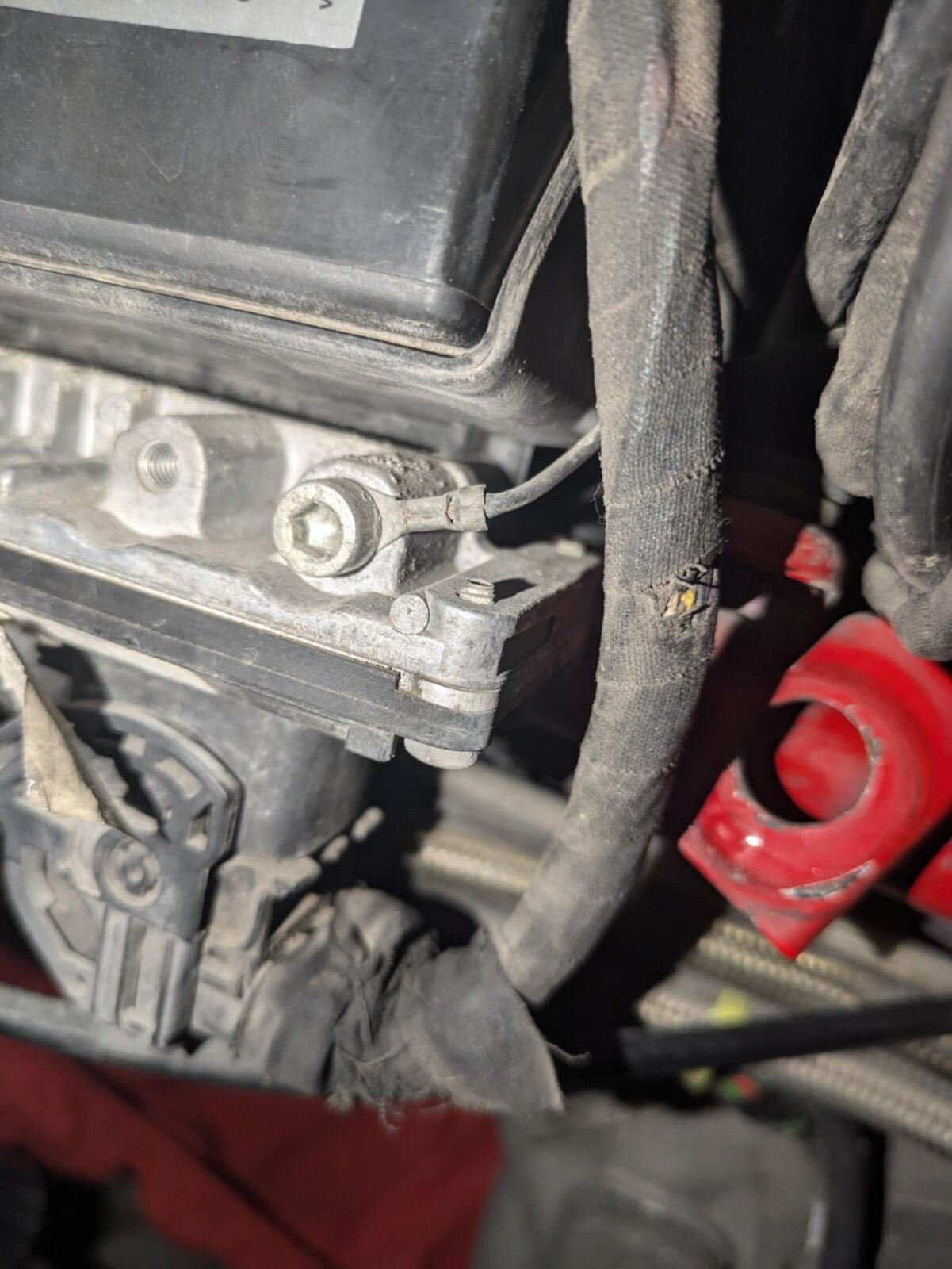

  2. 1. Makes sure you have connected the little black flylead under one of the ECU fixing bolts.

  9. What do you mean by "1. Makes sure you have connected the little black flylead under one of the ECU fixing bolts." The diagnostic tool black fly lead?
  10. On the wiring loom is a small black fly lead. It goes under one of the ECU bolts.
