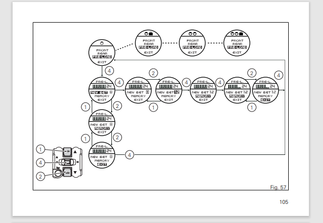

  6. OK, I'm confusing myself here.... wheres the rear pre-load adjustment in the menu ?
    Is it the single/or 2 rider / luggage or no luggage setting that adjusts the pre load ?
  7. You need to go into the settings menu to access it, hold the down button, left bar, for around 5 seconds I think, go to DSS settings then the menu you want to alter, e.g. touring, sport.... you'll see rear preload is adjustable from 1-24 I think.

  10. So I looked at the settings last night and there is no 1 to 24 setting i can see. The rear shock adjustment is offered as "softest" thru to "hardest" in 5 steps.
    Anyway I did a reset on the Urban mode, and now when I switch from Urban to Tour I can hear the rear shock move just a small amount.
    This all came about whilst I was setting the chain tension. I did it in Urban as per the book, but when I put the bike in Tour mode (where I ride 99% of the time) I thought the tension was bit to tight.
  11. It is in there, takes a bit of finding and getting used to the buttons and what they do.
  12. I think you were looking at the damping (compression & rebound) settings (5 settings, softest to hardest, can be applied separately to front & rear suspension) not the preload settings (for the rear sock only, front is manual adjustment) which offers steps 01 to 24. Changing the mode will change the rear preload as each mode has a different rear shock preload setting for each of the 4 load options (rider, rider+luggage, rider+pillion, rider+pillion+luggage).
    The best test is to change from Urban to Sport mode or in any mode change the load from rider to rider+pillion+luggage.
    There is a section in the Owner's manual on Customising the Ride Mode: DSS Suspension Setting, which can be downloaded in PDF form from the Ducati website. This is a polite way of saying RTFM :)
  13. Finally got to play with the settings and found it ! :upyeah:
    RTFM..... I usually do but sometimes things don't seem clear when translated from Italian to English.
    Or maybe its just me :confounded:
