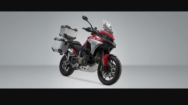

    I have a question regarding luggage. Has anyone fitted the SW Motech trax boxes to the V4S? There are only a couple of pics on google. I had these on the GS and loved them. Wondering if the 40litre each side are too wide and also if they interfere with the back of the pillions legs

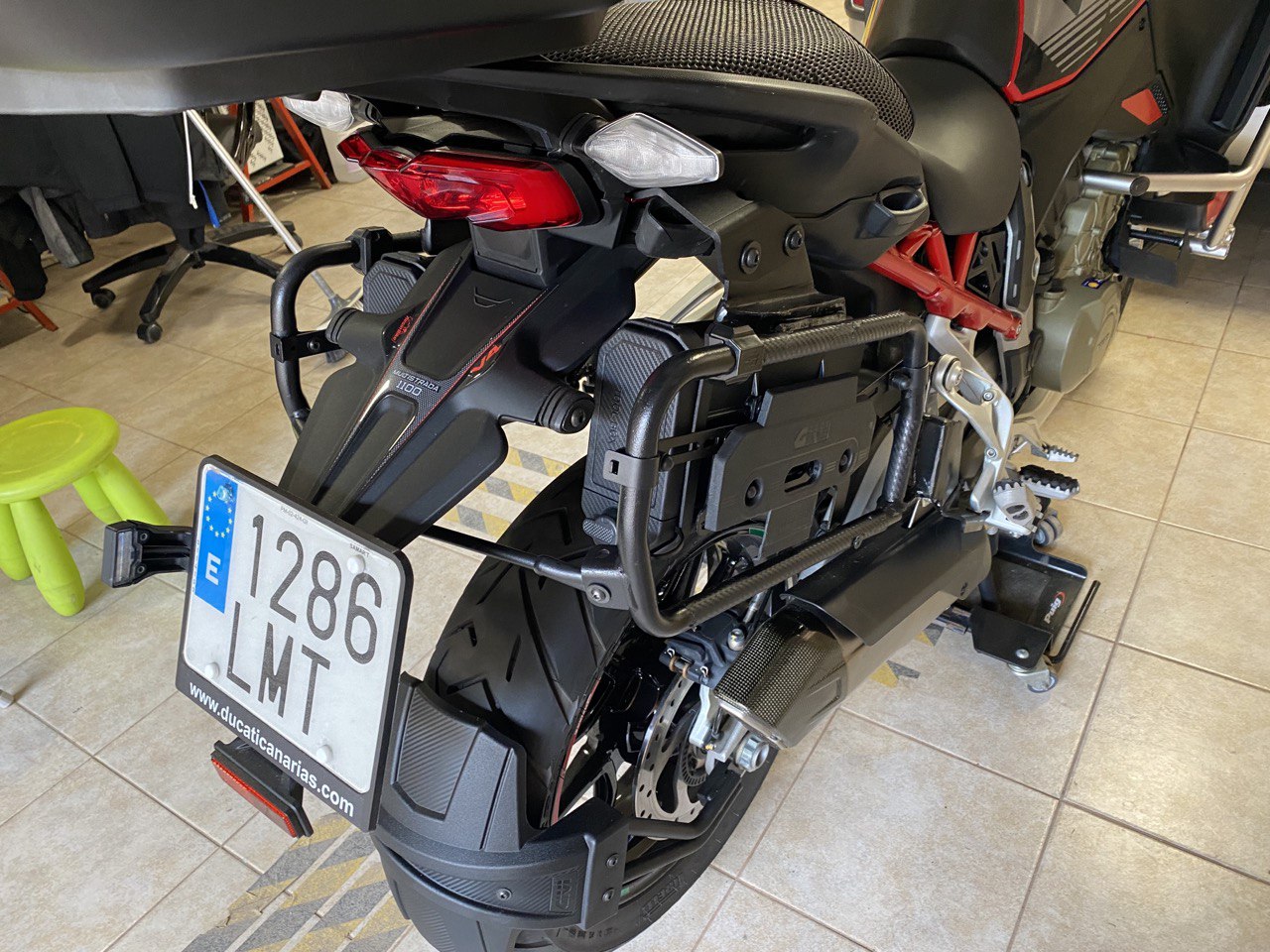

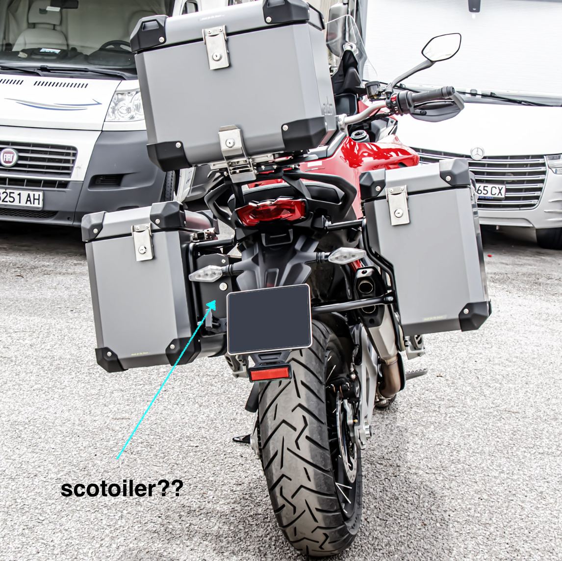

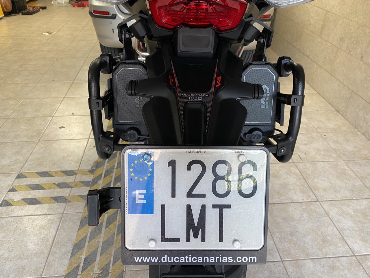

  3. If you look, the exhaust pipe has been modified so that they come out from below

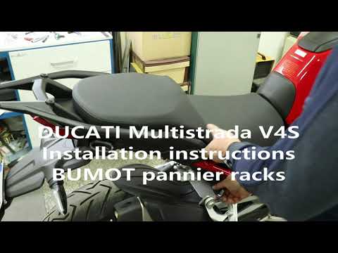

  4. With the sw motech the suitcase should be further away from the exhaust if you don't modify it, and the 40 liter suitcases if you put them both the same exceed the meter allowed by law at least in Spain, however the specific bumot for the multistrada, they carry their anchors and the specific exhaust case if you do not want to modify the exhaust
  5. Thanks for the replies. I didn't forsee the exhaust problem. Although looking at the promo vid on youtube (they dont show the exhaust side) they dont mention it
    Also on their thumbnails it shows a full case. Probably hve to go smaller on one side and larger on the other as I had on my GS
