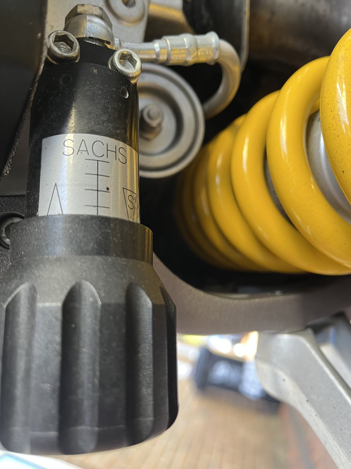

  1. Off on a touring trip tomorrow, night in Aberystwyth, then off up to Harlech & Conwy
    I’ve a poverty spec 2015 multi, I’ll be carrying a pillion, two full panniers, hair straighteners, hair dryer etc etc, the usual ! & a pretty filled to capacity top box
    18mm is the standard setting, where it is (approx ) in the attached picture
    I’m looking to stiffen the rear suspension for obvious reasons, what would be a starting point ?
    #1 Justatad, Sep 4, 2023
  2. Given how soft the std spring is.....I'd wind it all the way in with that load...better to feel its to harsh than bottom the suspension out constantly
