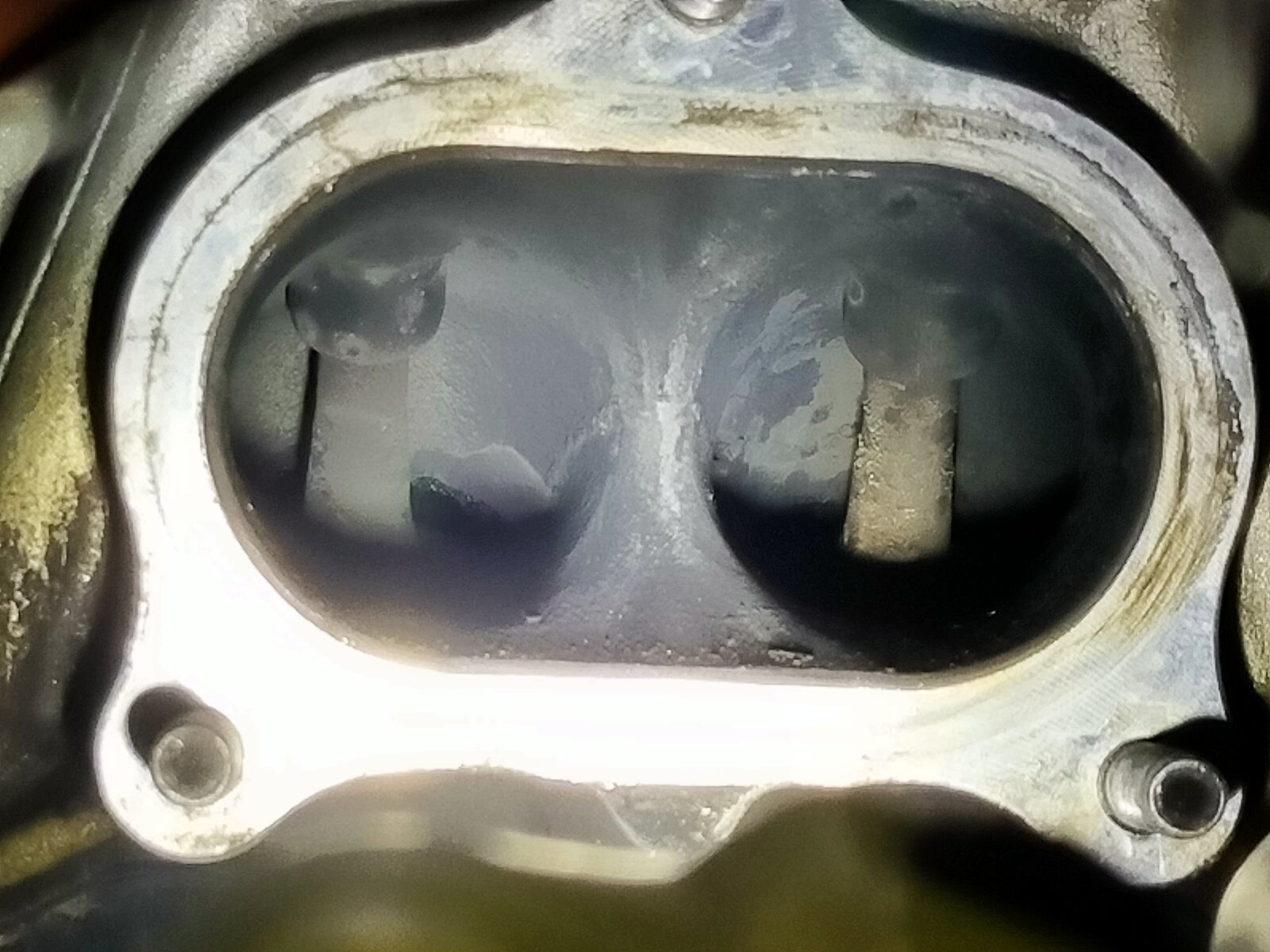

  19. IMG20221119112717.jpg the valve seems to be working ok. inside the cylinderhead does not look to healthy
  20. i fitted the new exhaust and tested the bike for about 5 mins, problem is solved. no popping/backfiring. the crack on the exhaust must have been enough to trigger the lambada sensor. spot on conman,thanks for all replies.
