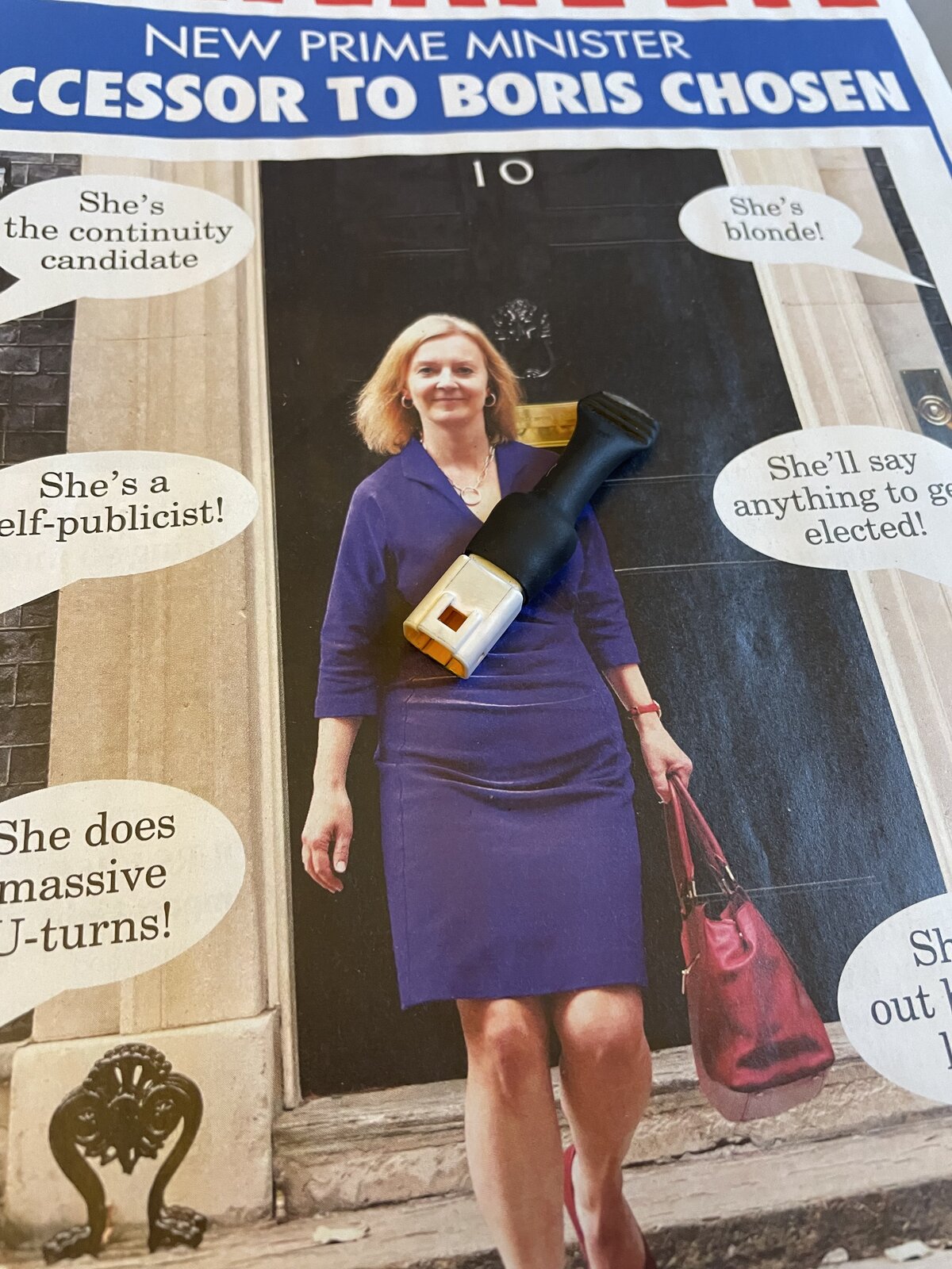

    These are the electric plugs I would like to know where to buy, if anyone knows?
  4. Thats the things. Excellent thanks Chris. I was looking for those everywhere but i got everything but.
