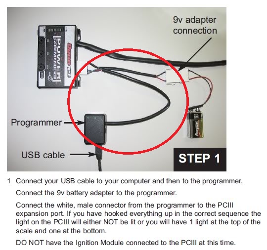

  2. One of these...
  3. When I did the firmware on mine I just used a mini usb cable and built a 9v connector. I have some 9v connectors that I built for £5 (inc p&p). You need to verify if you are 1.0.0.20 or above. If so you can use just the usb cable. For power, if on the bike switch ignition on or off bike use 9v adapter.

  4. I have the 9v adaptor and USB, but my firmware is earlier then the 1.0.0.20 so need the programmer to update it - Once it has been updated it will work fine with the USB, but really struggling to get my hands on a programmer.
