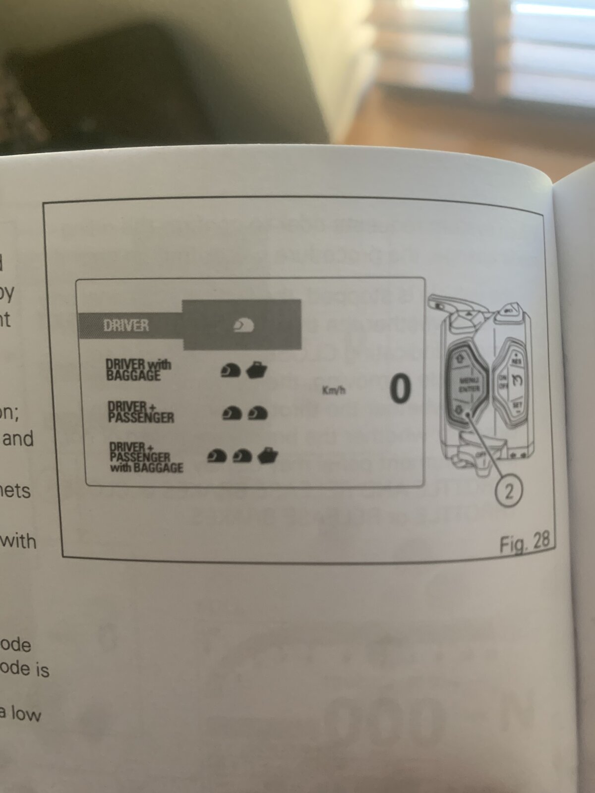

  1. Sorry for the numpty post but I have just returned from a Derbyshire tour with the pre load set to luggage and pillion but I seem to have had a brain fart and I can’t return it to rider only no matter how much I try.pic from the manual page that I can’t fathom.
    HELP!
  2. Push the Down arrow as shown in the picture.
    Highlight the option you want - solo - solo + luggage etc
    When you have selected the one you want. Push and HOLD the down arrow.
    After a couple of seconds the suspension will change.
  3. First, press and hold the down arrow for a few seconds.
    Then using up or down arrow, select the option you want and then press and hold the down arrow until your change is confirmed IIRC.
  4. Tried that but the page in the photo doesn’t appear . The page for rider mode comes up to choose sport,tour,urban etc.
  5. Just a thought does the engine need to be running?
  6. Press and hold the down arrow and the suspension setting page will appear
