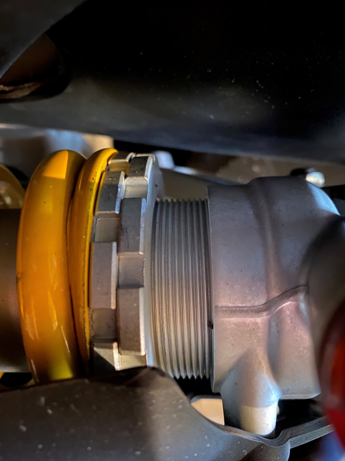

    But if it helps at all to cheat it for now, I had mine setup by Steve Jordan last year, I'm about 84kg without gear and have nine rings showing on the rear and he set at four turns in on the front. Front is spot on for my road riding, but I needed two extra turns when on track last year but that was at an ARD braking from an indicated 180mph+ (according to the laptimer) at the end of the runway

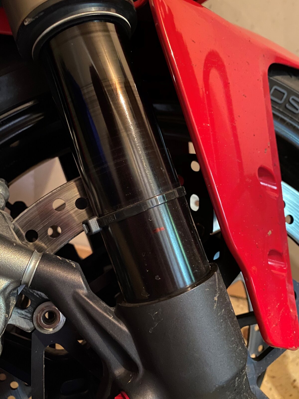

    I’ve set my front at 6 turns in, I’m nearly 50% heavier, and will add some other comp/reb settings I found. Not done rear yet, but that’s ok as I’ll set at 15mm static and see how that goes :upyeah:
  7. Yeah I find the front is easier to get right especially if you add a cable tie and monitor travel. One thing to bear in mind is the bottom out of the fork is actually significantly up from the actual bottom of the fork. I'm pretty sure it's 120mm travel on the front, measured from fully extended and marked with a sharpie so I know where bottom out truly is
