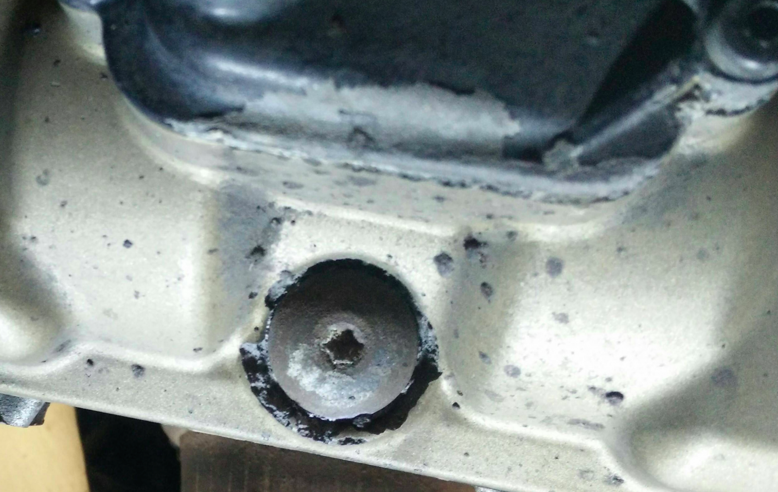

  1. ... but it does look like it might be dissolving:
    That's the lower cylinder head cover screw on the horizontal cylinder. Looks like the surrounding metal is crumbling away, and I'm not impressed, seeing as the bike's only just over a year old.
    I rode it through winter, but I hosed it off and slathered it in FS365 every evening without fail.
    Anybody else seen the same? Is it worth a warranty claim, or just keep my fingers crossed that it doesn't get any worse?

  2. I'd say salt has been at that , are the rocker covers aluminium or magnesium . If aluminium galvanic corrosion between the ally and the metal rocket cover stud , poor finish whatever it is
  3. Surely that's a warranty job....I'm checking mine shortly.
  4. Yes made of magnesium, and once any coating goes through it rots, thats what you get if you don't look after things
    • WTF WTF x 1
  5. Not as bad but yes mind is similar
  6. FS365 is a waste of time.
  7. What am I meant to do, lick it clean after every ride? Keep it locked up in a heated and dehumidified garage until after the spring equinox?

  10. If you washed it after every ride, you were washing it too often. You would just be making the salt corrosion work even better especially as the bike would have stayed damp all night.
  11. I didn't wash it after every ride (who the hell has time for that?), I hosed it off with cold water to wash the salt off. That's just getting it wet, so it can't be too often.
  12. Yeah your right , ACF 50 every time.

  18. My dealer's taken some photos to send to Ducati, of the corrosion and of the general state of the rest of the bike (which is otherwise pretty good).
    He's not optimistic about warranty claims for corrosion, but I think the fact that it's not just surface marks has got to help. We'll see...
  19. ... and the man from Ducati, he says, 'No'. What a surprise.
    Right, where's the local BMW dealer? I wonder if they've got a S1000XR demo bike yet...
