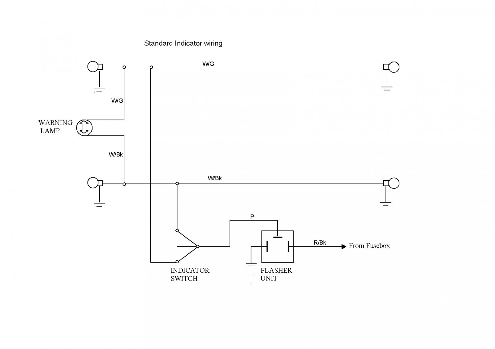

  2. I have seem similar problems when all indicators are changed to LED. The warning lamp in the dash is a filament bulb, usually 1.2w, and is wired across the right and left flasher circuits. When the one side is on the warning lamp earths through the bulbs off the opposite side. Since the warning light is a low wattage bulb there is insufficient current to light the bulbs on the other side but LEDs require a very low current to operate and you get the hazard light effect whichever side switched on.
    This is the standard set up (ignore the wire colours)
    This has been modified with 2 diodes to provide a warning light without the hazard effect.
    You could still use a bulb for the warning light instead of a LED.

  7. The indicator warning light has 2 wires going to it, a white/black from the LH side and a white/green from the RH side. You will need to cut both the wires near to the idiot light cluster. Connect one of the wires from the warning light, say the white/back to earth. Solder a diode on to each of the 2 wires from the loom with the ends with the white band both connected to the other wire from the warning light (white/green). Make sure you insulate all the joins, preferably with heat shrink sleeving. This will allow the warning light to operate without activating the LED indicators on both sides of the bike simultaneously.
