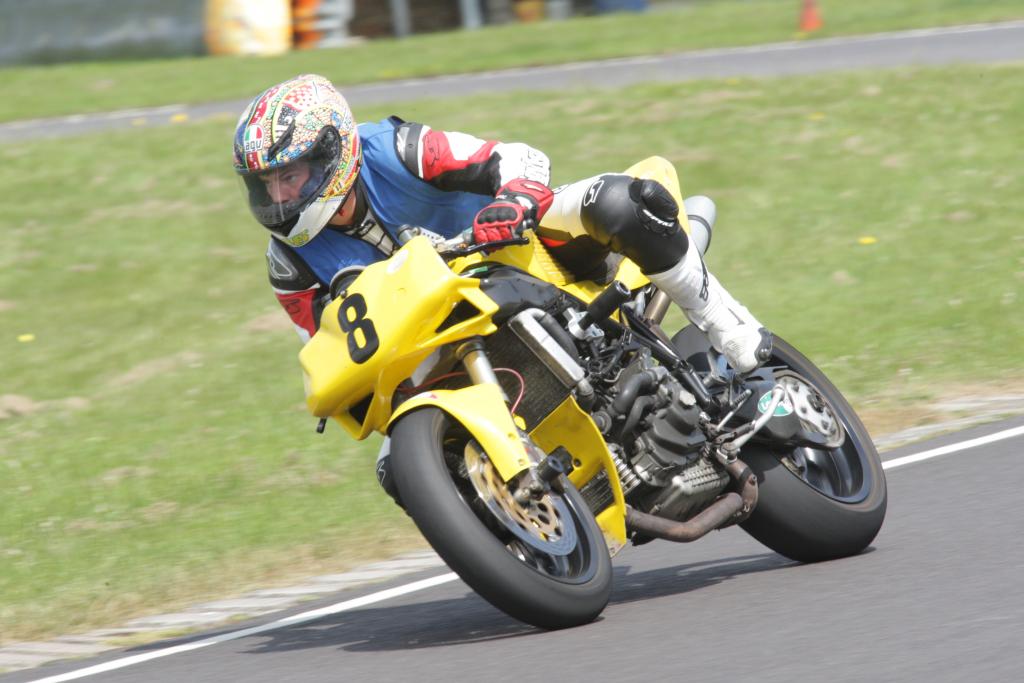

  1. I am looking to have Mark at MADASL build me a lovely little track toy for when I return home. He currently runs a 748 called Daisy (available for hire dontcha know) which was the most fun bike I've ever had the joy of riding. Using Daisy as inspiration I would like to run a bike of similar styling and design intent. The theory is that I would use a 749 as a base but re-imagine it so that it actually works when I want it to and is easy to repair if/when I fall off on track days.
