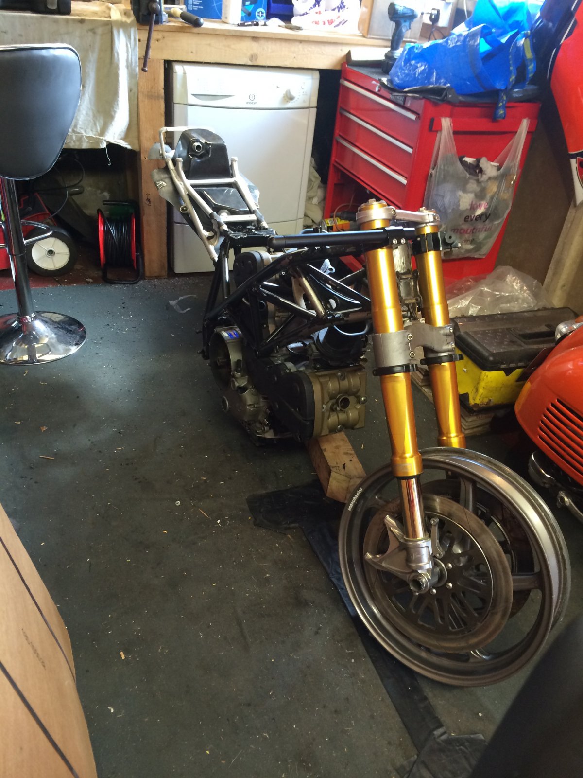

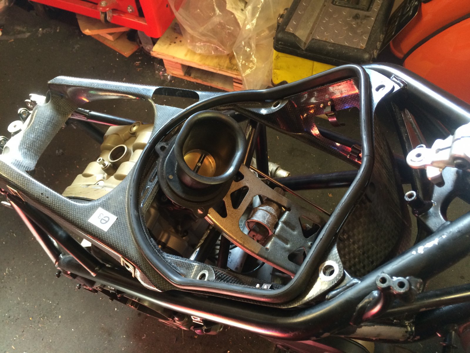

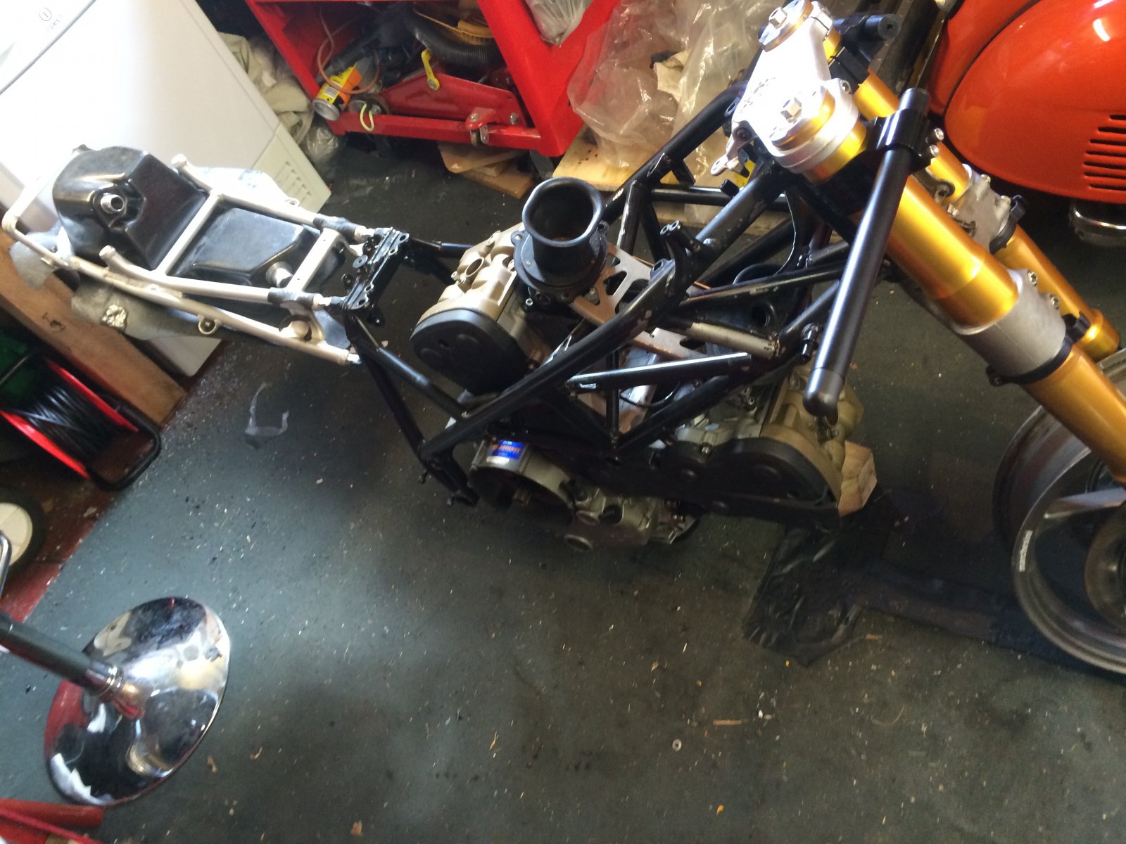

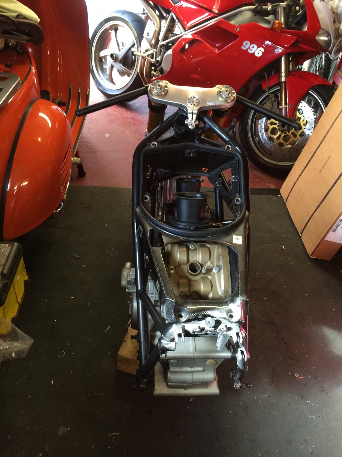

  1. I've been working on collecting bits for my race 748 framed project, so thought a build thread maybe usefull.
    Still collecting parts, having bits altered/made and modified...however will commence building soon. Spec will evidently change along the way...but most is sourced.
    Brief spec below -
    - 748s frame (modified)
    - 1098s motor, Corse close ratio box
    - Leovince Titanium 57mm 998s system (modified)
    - Ohlins Radial billet bottomed forks with 30mm Nix carts
    - standard yokes (modified)
    - custom wheel spacers
    - ohlins steering damper
    - Brembo Hpk Calipers
    - pvm wide track cast discs
    - billet clipons (modified)
    - Marchesini wheels (still like a set of mags or forged)
    - 19x20 brembo forged radial brake master
    - 16x18 brembo billet radial clutch master
    - p8 ally sub frame
    - cm composte large breather tank
    - corse/ms production carbon Kevlar 998rs panels
    - 748 rs carbon front subframe
    - standard road Swingarm (will eventually be a mag long arm)
    - ohlins rear shock
    - Cm composite carbon battery tray
    - ms production carbon Swingarm guard
    - 748r carbon airbox modified with removable sides etc
    - translogic dash
    - 748 loom ecu etc
    - corse style rearsets, carbon guards
    - various titanium bolts
    - plus loads more
    Toying with the idea of a 1098 loom/ecu/dash etc to make life easier...
    Pics of loosely assembled bits before I send frame off for welding and paint -

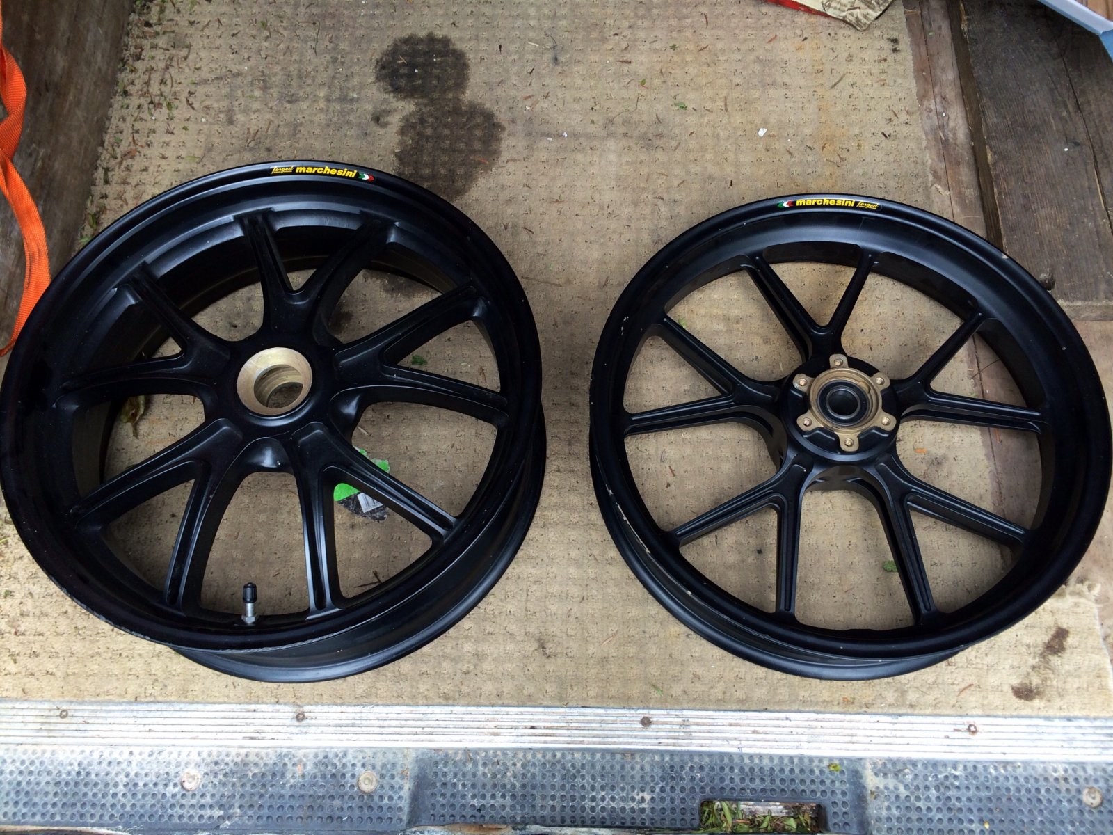

  17. Quick update...found some new wheels.
    17" forged Magnesium jobs :)
    Can't believe how light they are!
  18. I have a forged HyperS on the back of my road bike, originally I didn't want to fit it, but to retain the period correct 5 spoke 'lightweight'.
    That was until I held the newer item in one hand and old wheel in the other!
