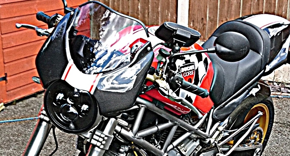

    Put in an LED headlamp on the Monster, dont know if I prefer the OE one

  8. Good job! I think the original headlamps do look better, but unless you never ever ride in the dark, the LED is the one to have...
  9. Old lamp is back on , might swap over the LED in the winter again
