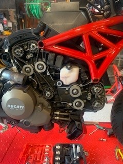

  1. Help needed !!!! Out last weekend and managed to snap a cambelt on my Monster 1200s (14 plate). Before anyone asks I've had it 14months 12k on the clock, full service (dealer) and belts changed by the dealer I bought it off (allegedly). So what do I do know now? Have stripped it back as far as I can more out of curiosity than anything else. Apart from finding a "spare" woodruff key inside the cam belt cover I cannot really see what's failed apart from the belt obviously (looks like candy floss). The pulleys on the head seem solid (cannot be turned by hand) so expecting bent valves at a minimum. So, do I whip the head off (no idea how) or push it down to Marsden cliffs and send it back to it's maker. Does anyone know anyone sh*t hot in the North East to take this basket case off my inexperienced/incompetent hands to fix it properly

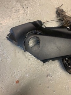

  11. Monster3.jpg Fairly knackered Cambelt if I say so myself

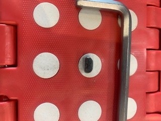

    Monster5.jpg "spare" woodruff key lying in horizontal camcover

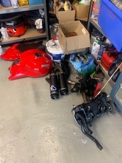

    Monster1.jpg Airbox to remove (still) then head off I think
    Couple of question. I assume the head can come off with Engine in situ ? What tool do I use to get to the nuts holding the head on. I can probably get them off with a spanner but what about putting them back on (torque etc)
