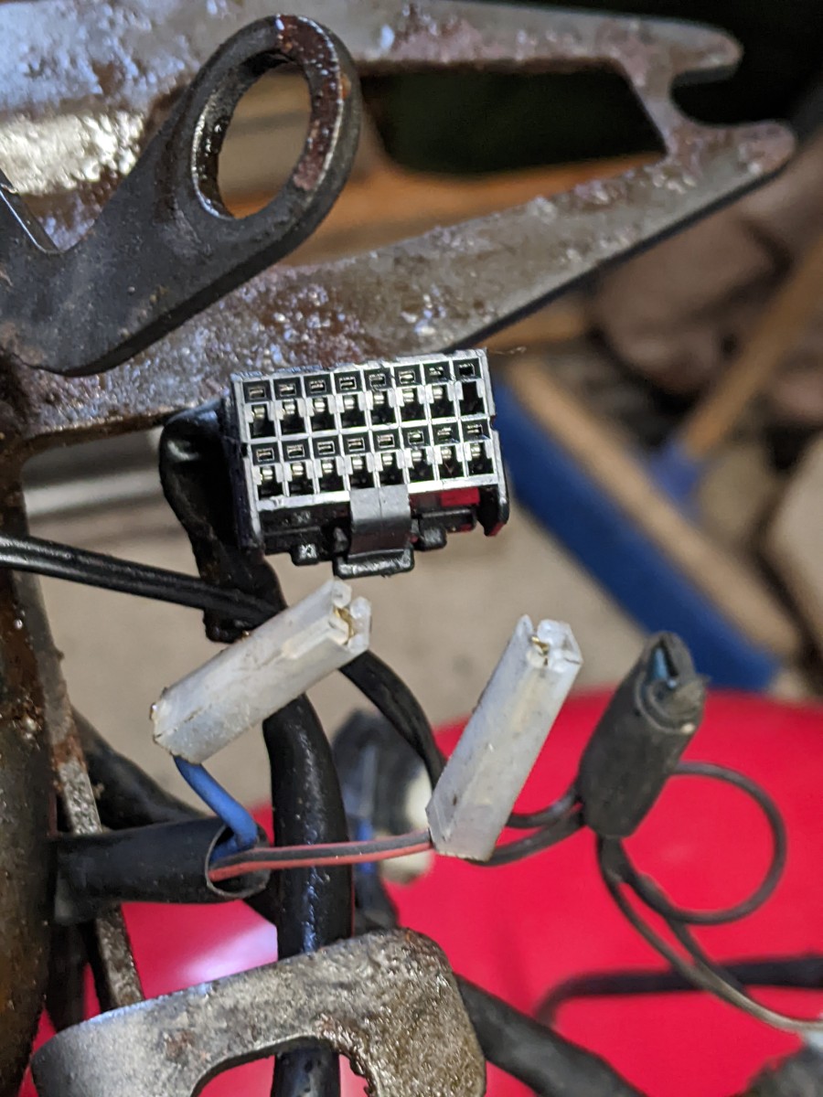

  1. I have started to remove some of the electrical stuff off the raptor which has, of course, left connectors open to the air. The air being inside an unheated garage that does allow a little condensation to form.
    They will be in this environment for some time, months if not years (ho hum), so what's the best way of protecting them from corrosion/furring up?
  2. Next time you fill up at your local garage, grab a handful of plastic gloves they provide, cut the fingers off and use some electrical tape to secure the finger over your connector. Surgical style gloves do the same job. Andy
  3. Acf50 it’s what it was developed for
  4. I would go with Dielectric grease

  5. Ive used thermal paste before. Works well. The stuff you use for CPU's on PC's. I had a tube of it and thought 'why not'. Its basically a conductive grease.
    • Disagree Disagree x 1
  6. Might be a different stuff you used but normal thermal paste is non conductive so it doesn't short out the motherboards.
  7. Thanks guys... thinking about it a little more, protecting the connections from corrosion whilst they are apart is the half of it. You also don't want it to dry to a film that is then unable to be pushed off terminals, & prevent electrical conductivity, when the connection is finally remade.
    And for some reason dielectric grease seems to me to be the better option.

  10. As others have said Dielectric grease every single time. Yoiu don't need to smother it on. just apply a thin film across the pins of each connector or over any terminal fitting. Don't be tempted to use vaseline as it's not really that effective. I also use Dielectric grease on the network connectors of my outdoor cameras which protects them from any damp, condensation or moisture. 5 years later and zero issues.

  12. There is, of course, ACF50 grease instead of the liquid version.
  13. From experience, don't use any spray/grease that's an insulator, WD, ACF etc....It's Good for washing moisture out, then cleaning with Isopropanol Alcohol, but ultimately it's non conductive.
    Switch cleaner or electrical contact cleaner is your friend.
