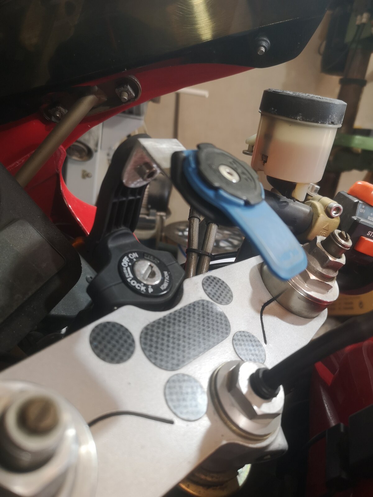

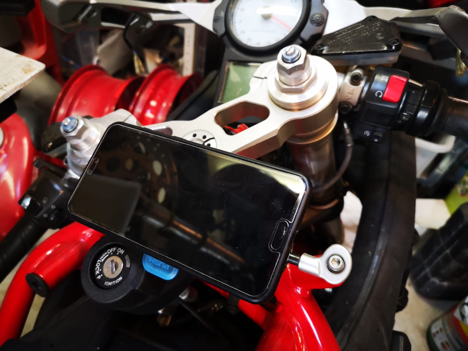

  2. Supersport carby models.
    With a small aluminium L piece...

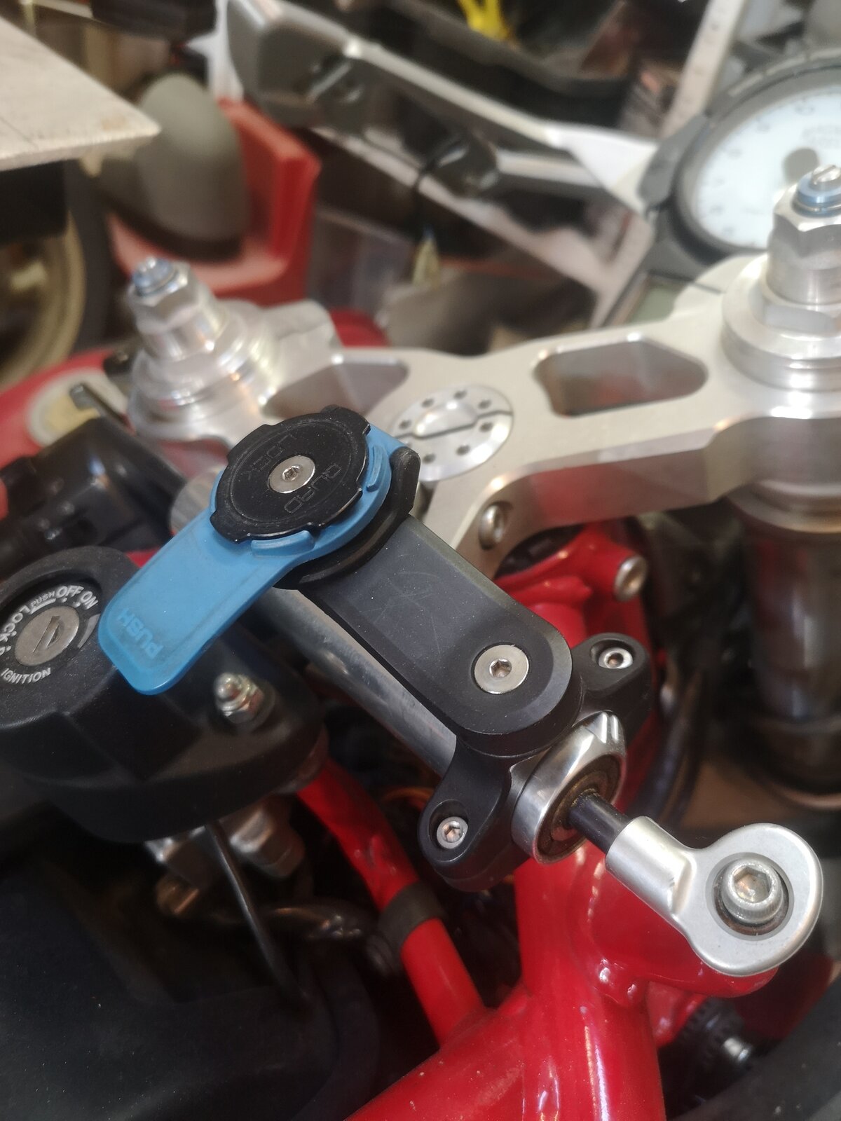

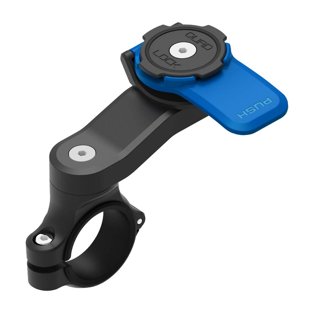

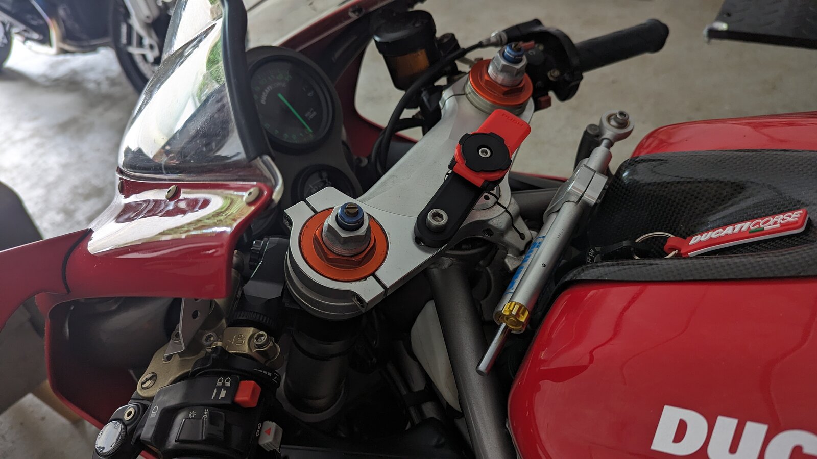

  4. 999/749
    Same Quadlock mount:
    Make sure you are all the way to the right on the damper to avoid any fouling.

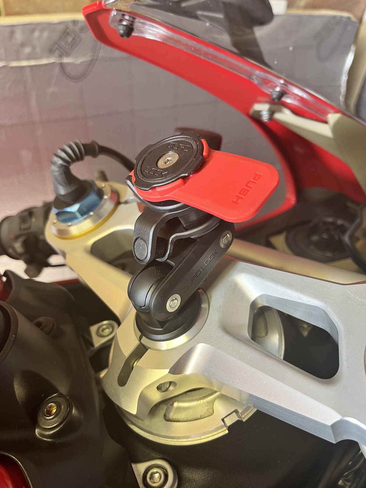

  9. Panigale 1299s > Here’s my Quad Location with the anti-vibration adapter. It is worthy to note that Quadlocks don't fit the Panigale stem and therefore they don't show as a compatible bike. A simple 3D (£10) printed tube is available on eBay which makes the mount compatible. IMG_0141.jpeg

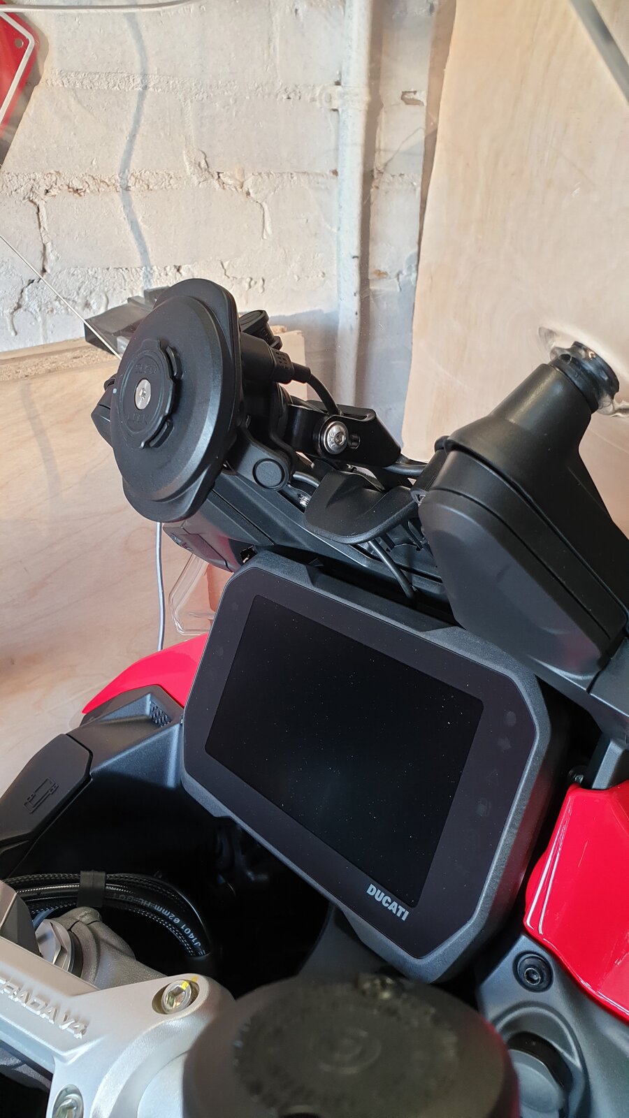

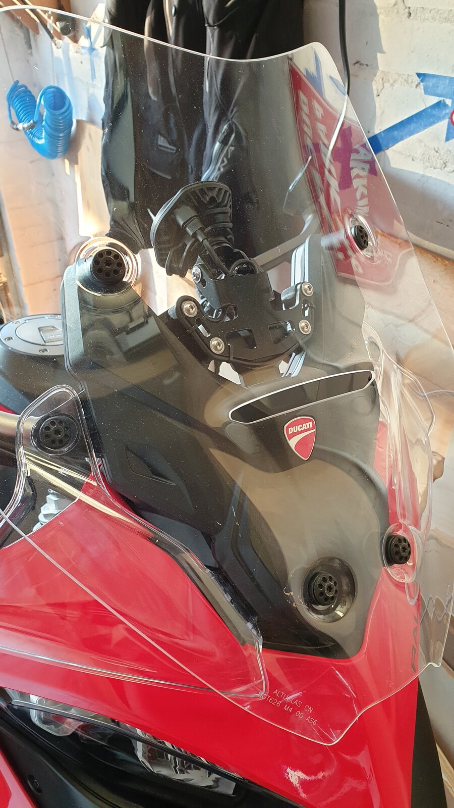

  10. I've got the Iconic Parts bracket mounted to the screen, so it raises with the screen. Wiring soldered to the sat nav connector blank leads, and set to "on", as the connector is switchable with ignition. Well pleased with it. Enough clearance for the windscreen hand adjustment. Using the phone in landscape, as it's the matching the main display.

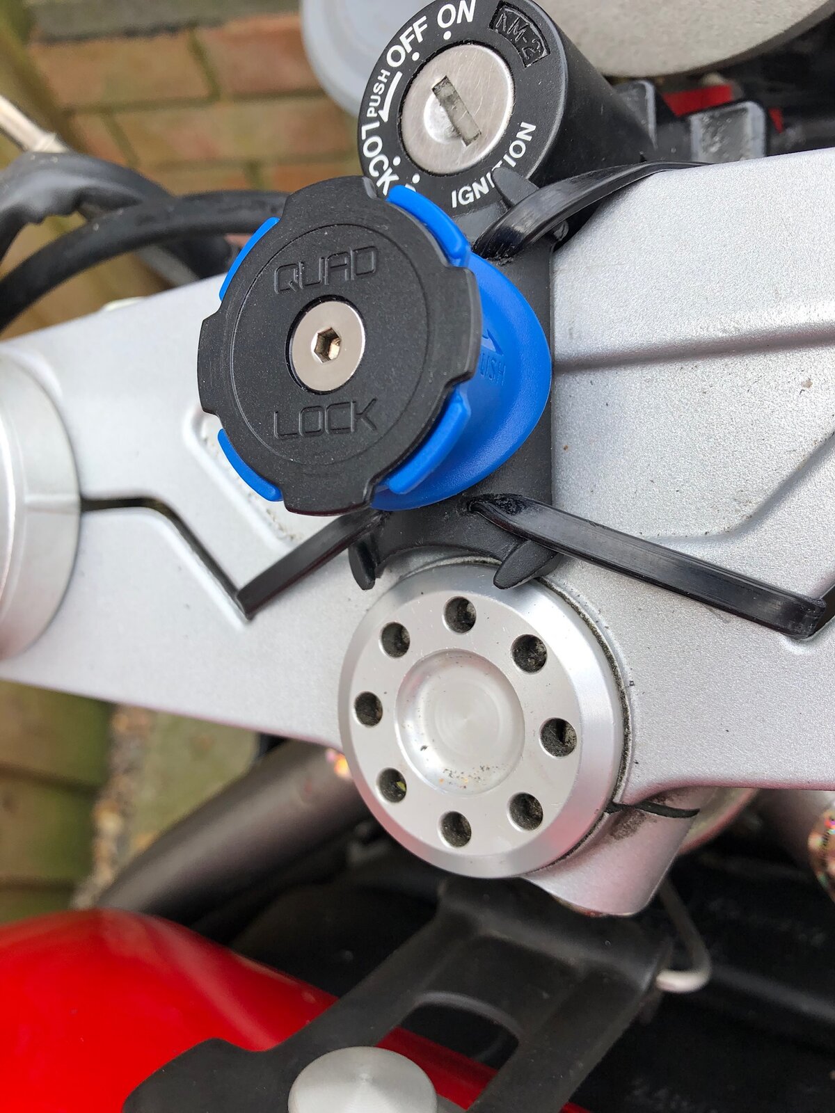

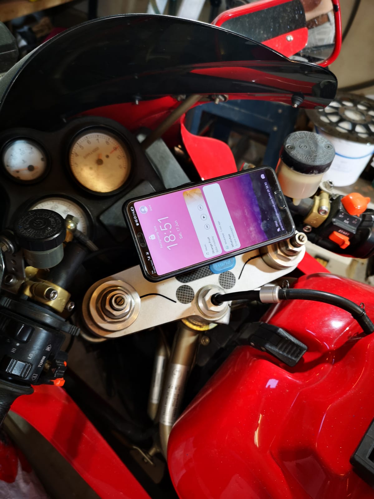

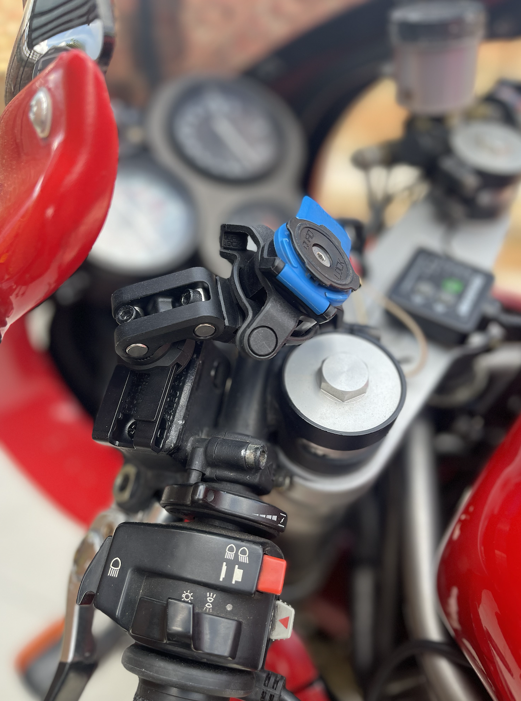

  11. 01 SS

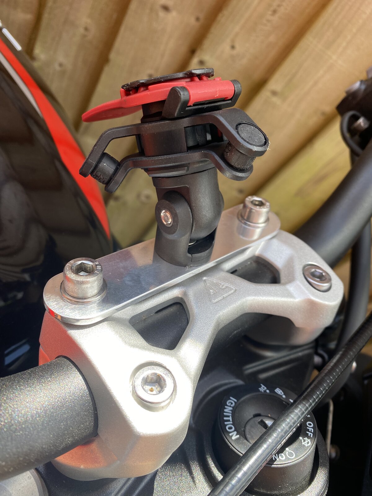

    21 Street Triple
    On the SS I have never used a vibration dampener and suffered no damage to the phone’s optics. My theory about vibration damage is that the closer the phone is mounted to the center of the top yoke the better. Mounting anything on a stalk off of the bars is chancing your luck as the stalk will amplify the vibes. With max power being delivered at only 7,500 rpm is also in the SS’s favour.
    No need for the charging pancake on the Street Triple as the bike has a USB port as standard.

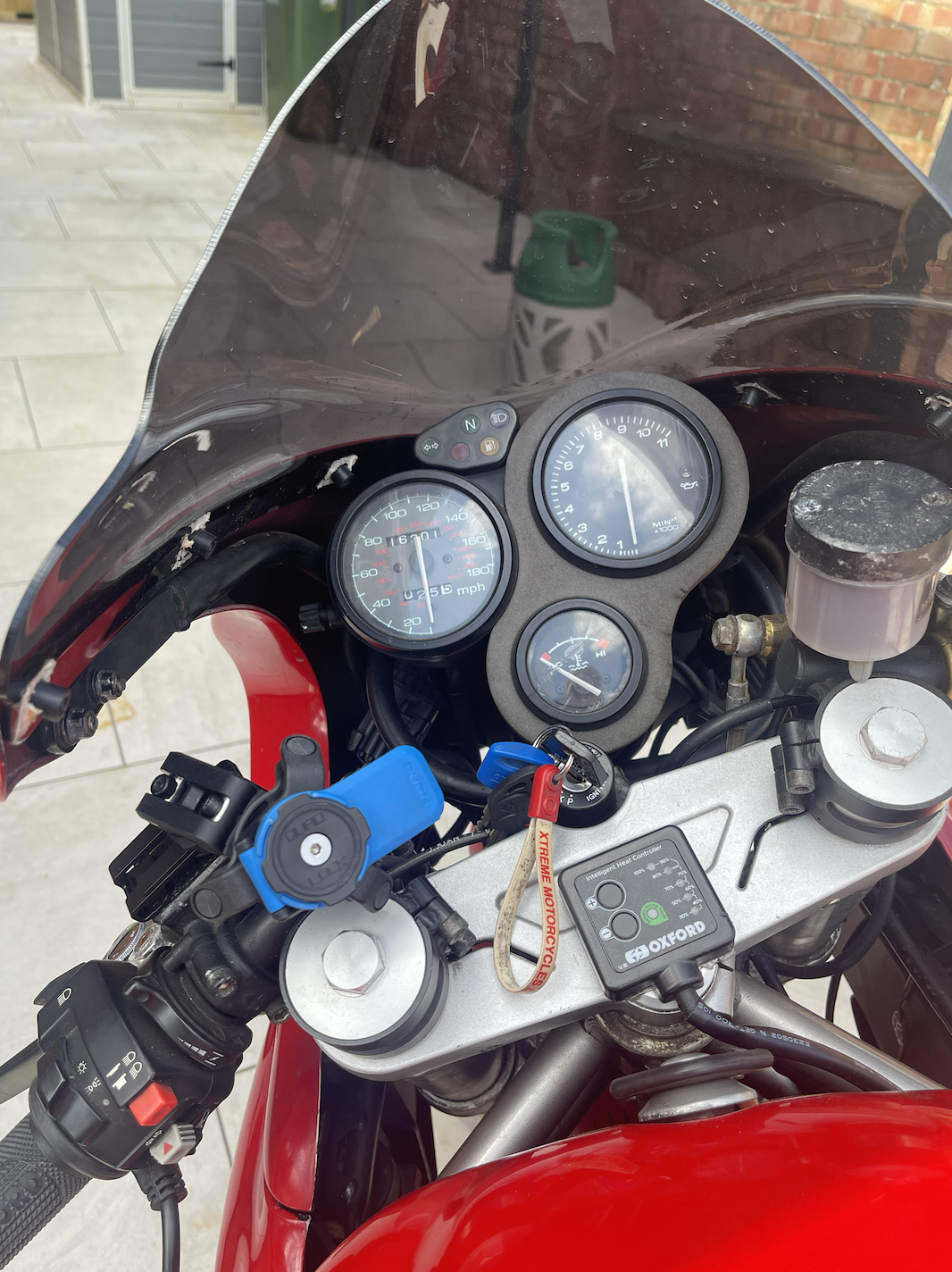

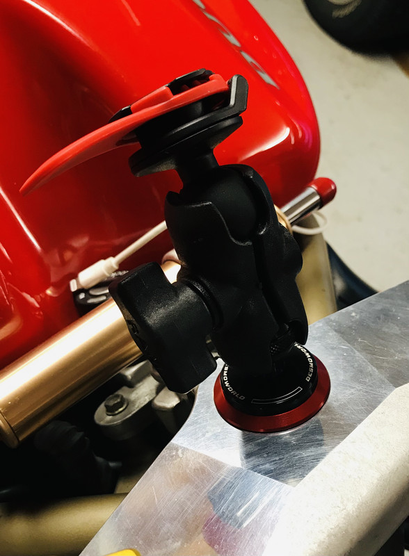

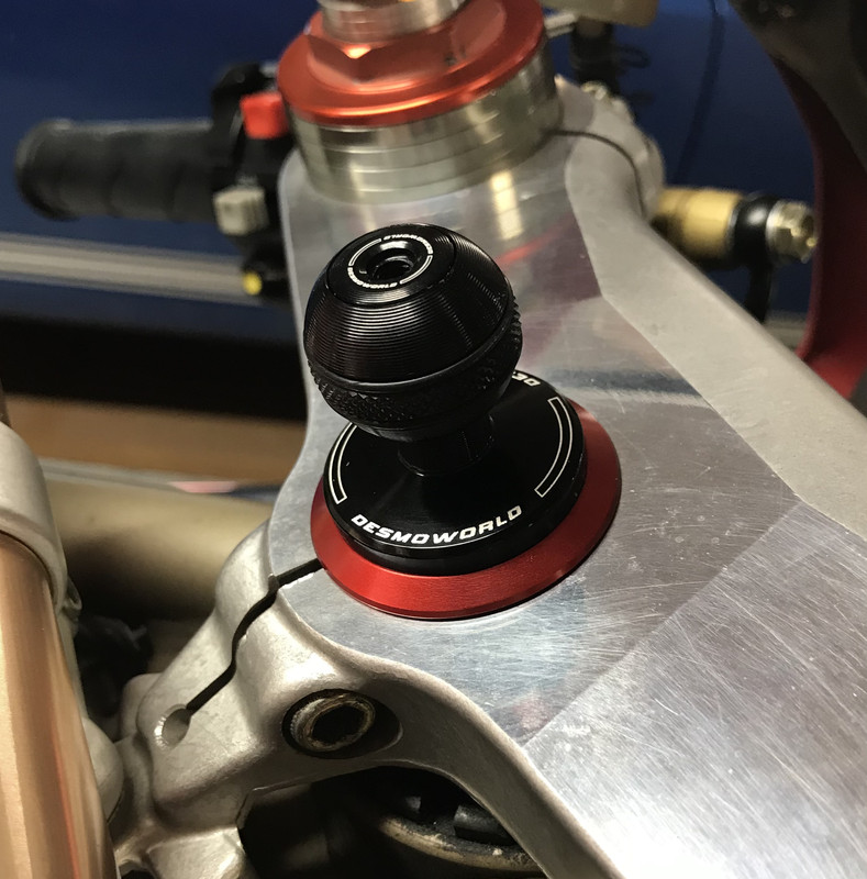

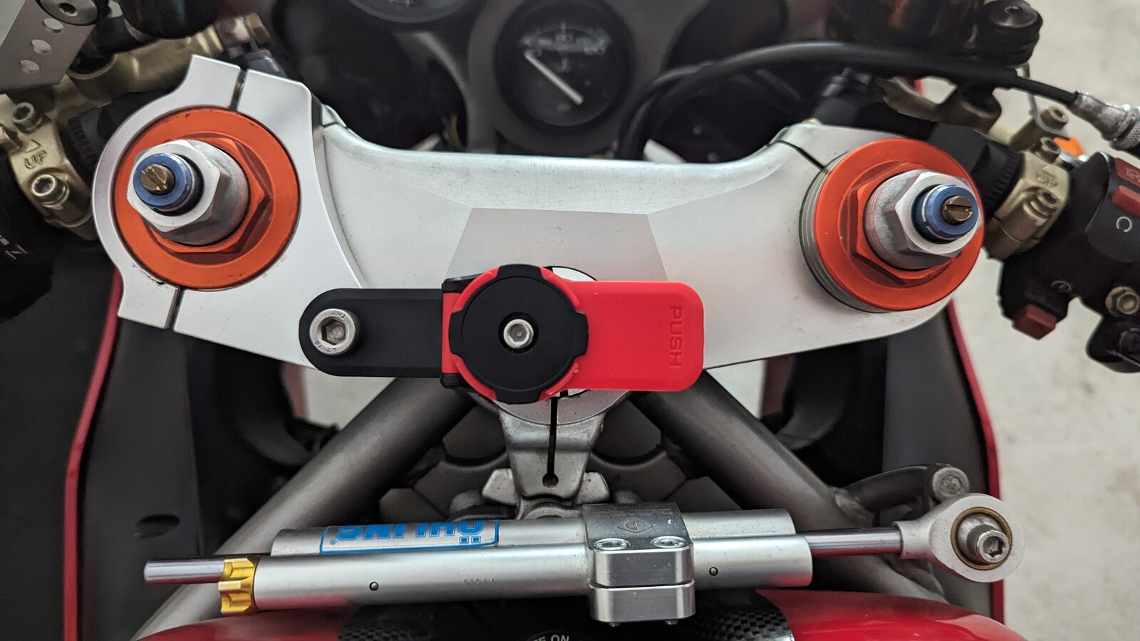

  12. 916/996/998.
    F1DDFF48-BE85-4ADC-931F-295FFD459276.jpeg D9E0D136-AC72-4595-B2B1-7C97CB16A681.jpeg B815C789-0AFB-4480-801E-3D7D1A79A257.jpeg C8937C32-35E3-4A5A-B9EC-38F8A9B5E337.jpeg
