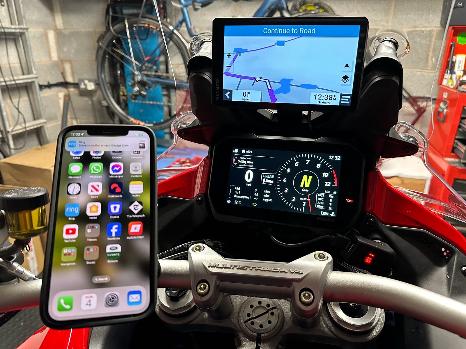

  3. IMG_0858.jpeg The dash screen is pretty well protected in its adjustable mounted position so I'm not sure what you're protecting it from. (It's not a touch screen) Most popular device mounts used in the UK are made by Evotech Performace and Iconic. Their mounts can be purchased with a quadlock adaptors or a Garmin adaptors. I decided to mount a Garmin above the dashboard on an iconic mount and put a quadlock mount on the bars. You can also get device mounts that use the handlebar bolting position.
    One minor issue I've found is the Garmin XT2 is quite heavy and when the windshield is in the highest position you do get a bit of 'bounce and vibration' on the Garmin, this comes from the way the screen raising mechanism works, it has a bit of play in it.

  7. 1. Iconic mounts screen mount with a quad lock charger/case, I have the vibration mount on mine but I don’t think it’s actually needed. Screen has a little bit of bounce so almost self damps. Ive tied the vibration mount up a bit with a cable tie. May remove it completely
