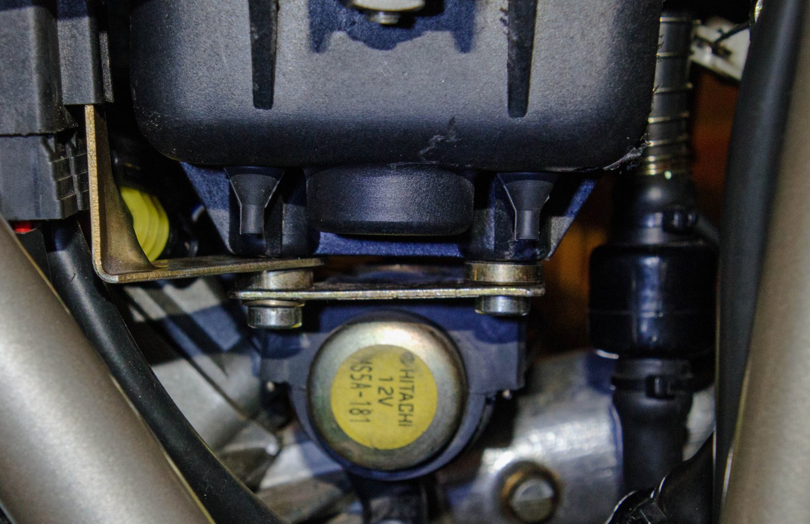

  1. Sorry daft question of the day! I have removed the carbs and had them cleaned and rejetted. Putting the bike back together tonight and all going well - amazingly haven't got a spare nut and washer unaccounted for yet......
    Attaching the starter solenoid to the bottom of the air box / battery holder, I can't remember the order of the washers - have I got it right in the attached picture?
    Thanks in advance!!
    Neil
  2. Doesn't look right to me.......
    I would move the left hand bracket so it's the other side of the solenoid plate and have washers on both bolts after that.
  3. Thank you - much appreciated and you are absolutely correct - there is a slot on the bracket that now locks into the solenoid plate. Obvious when you know how! One of the lock washers is missing so will have to get another at some point. Thanks again!
