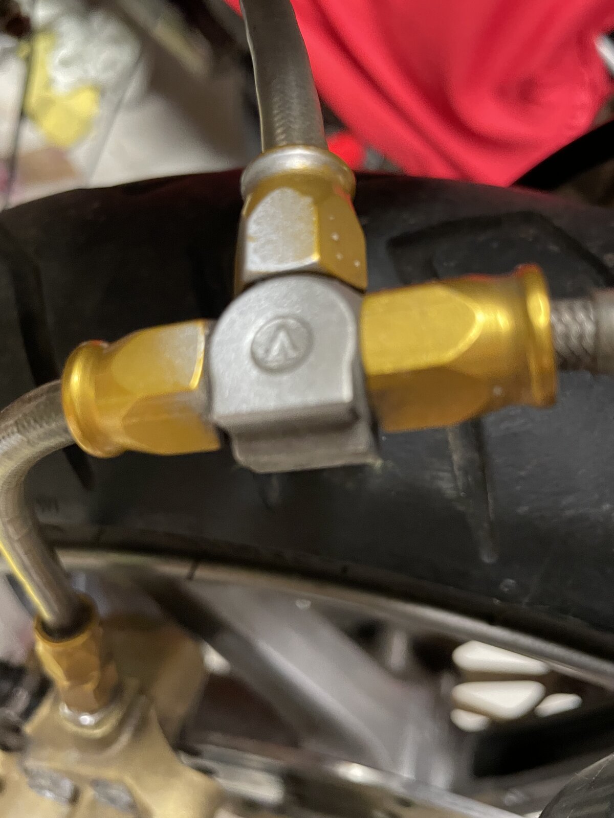

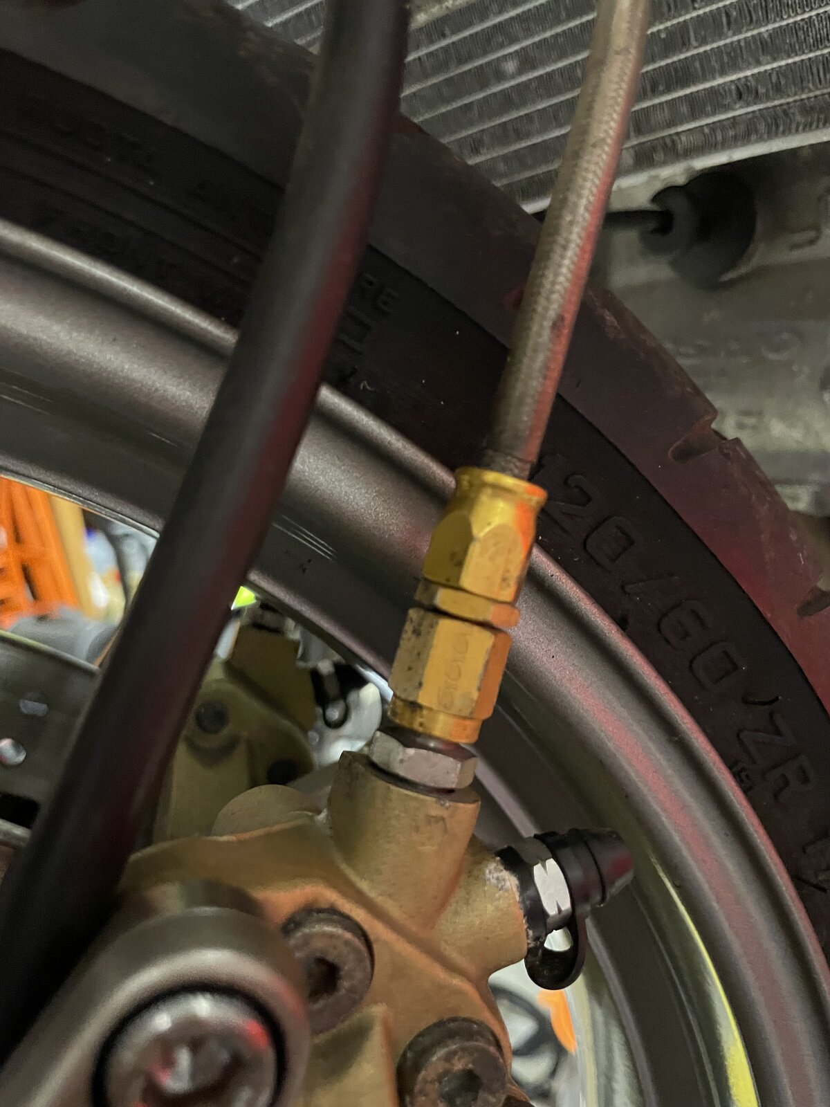

  1. More help. Can anyone tell me if these are QR brake hoses? If so, how do they work? If not, what are they?
  2. They are not, they are screw together -3 AN fittings for teflon braided hoses. Someone made the brake hoses at home. Nothing wrong with those fittings other than being Aluminium. They aren't supposed to be used on brakes as the pressure rating is too low. Saying that, I have used them on brakes without problem.
  3. Thanks. That’s useful to know. I think they are Venhill judging by the V on the union. I will most likely bin them off for some HEL lines just incase this bike ends up on a track.
  4. As said earlier, they’re not QR unions, just old fashioned ones that for some reason don’t use a banjo fitting. I had them on my 96 748.

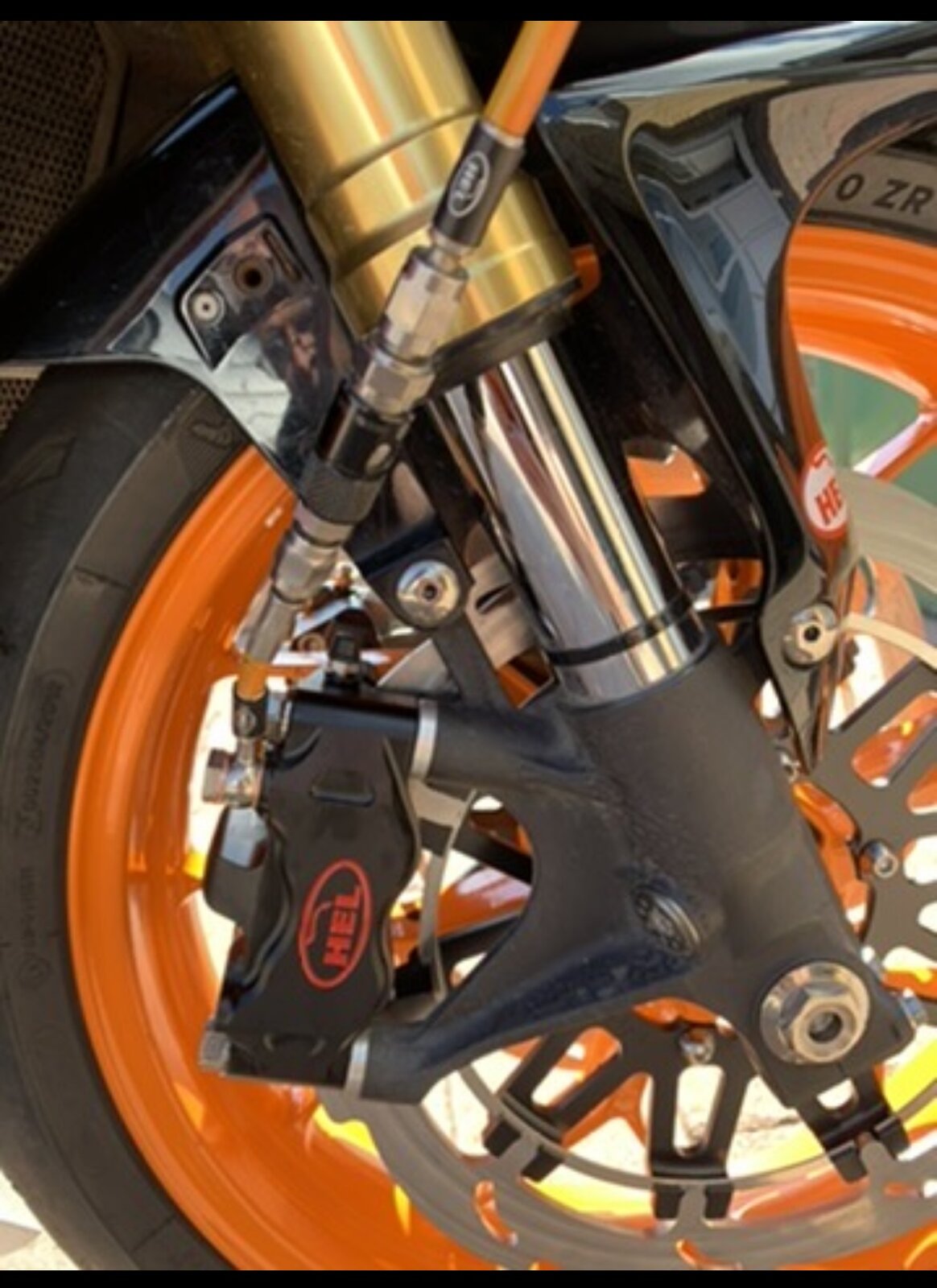

  8. This is a quick release line mate, unfortunately hel don’t do them anymore though as I wanted them on my bike
