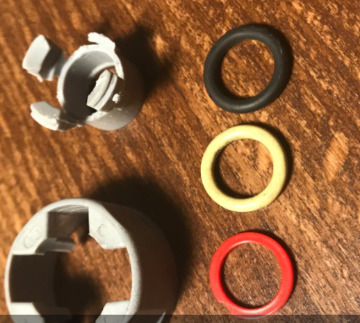

    I managed to get the fuel line out of the pump, albeit by breaking the clip - which I have sorted a replacement - but now, I need the o-rings that go round the elbow into the pump - which one has split, one dropped down the bike and the other is on the shelf. Any ideas on where I can get a 'set'?
    The yellow and black ones are rubber and the red hard plastic.
    As ever, I really appreciate the help.

  6. The rings aren’t available from Ducati. Tbh, the connector isn’t a serviceable part. It’s quite widely used in automotive fuel systems so you may be able to source them elsewhere, but not Ducati.
  7. Thanks, kind of came to that conclusion - I will measure them with my digital caliper and just get an alternative.

  10. Thank you guys, bought the part from Fowlers. I see what I did wrong, managed to source some o-rings of the same size also. So, all being well it should be fine. Thanks for help as always.

  12. You need to dismantle that Guzzi connector and just use the grey plastic end piece, its that, that breaks.
    I now have a spare taped to my fuel line in case its needed. ;)
