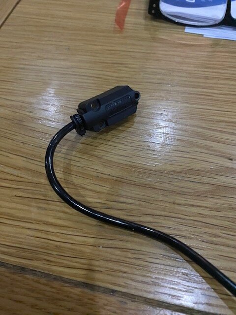

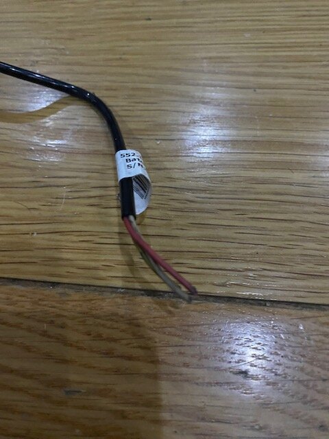

  3. The sensor connected to the quick shift. Im not sure how else to say it. `see pics (hopefully they will show). bike is out of warranty, but only done 7000 miles. the sensor wires are no longer connected to the loom, they've broken right at the connector.
  4. I don't think that part is available on it's own, it only comes as part of the quickshifter I believe. However you should be able to get a new plug and get it re terminated, worth checking with a dealer, I'd enquire with Neil at Cornerspeed, he would know.

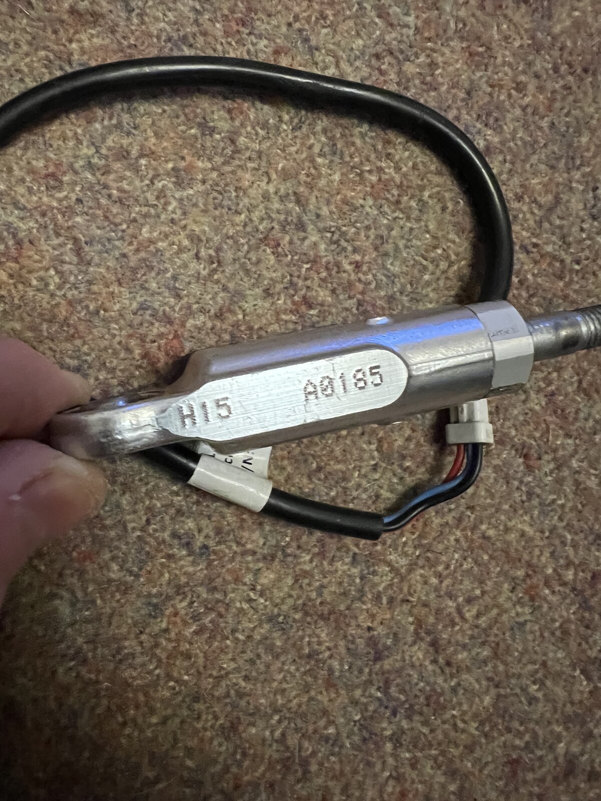

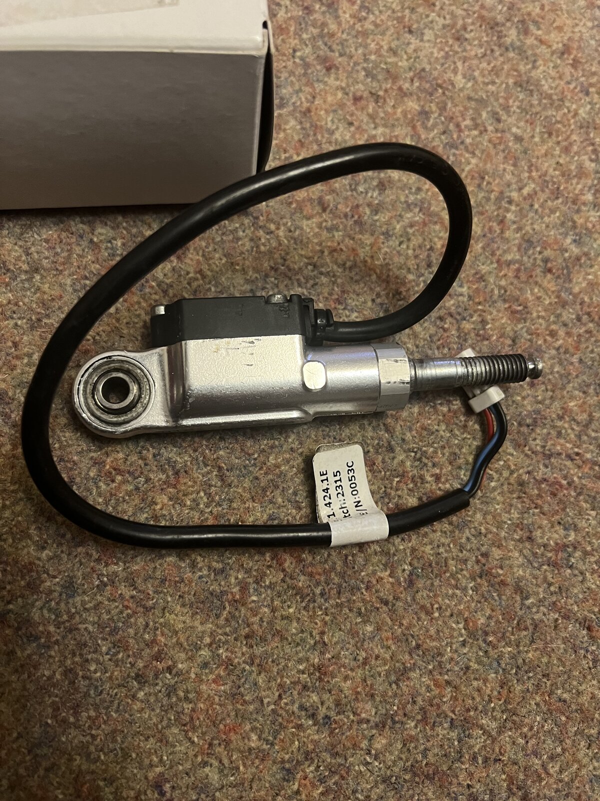

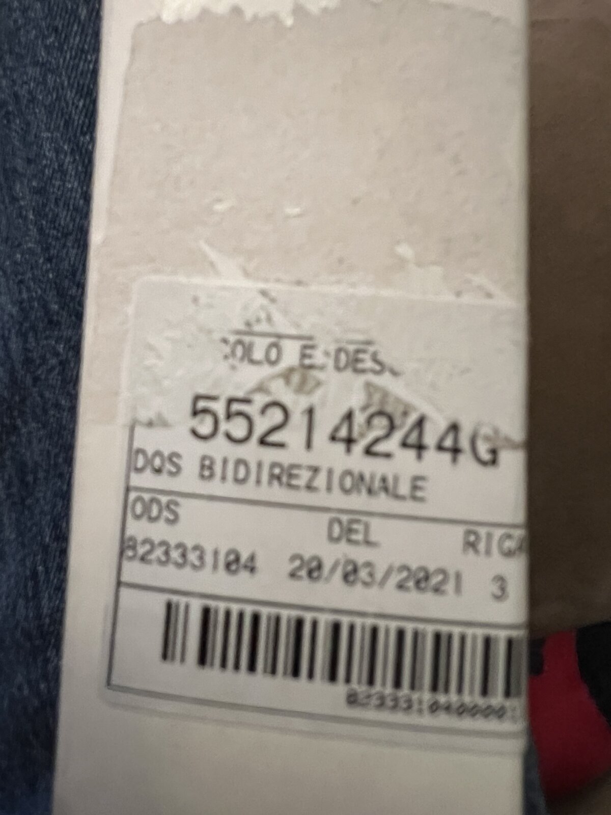

  5. I had to change mine on my 1299, it wouldn't upshift, I took it apart after fitting a new one, adjusted the switch parts and I think it will work, if nothing else the plug could be cut off and put on yours. Perhaps somebody with more knowledge could confirm if it will be compatible. Box is from the new one.

  6. Kartman, thanks for pointing me in the direction of a good person. Appreciated.
    Andrew 46, thank you. that's very kind of you. I'll PM.

    Duncan, very kind. Thank you. I managed to get a new connector for my existing cable, I have attached it and the err message has gone, I just need to get out on the bike now to see if the problem is resolved.
