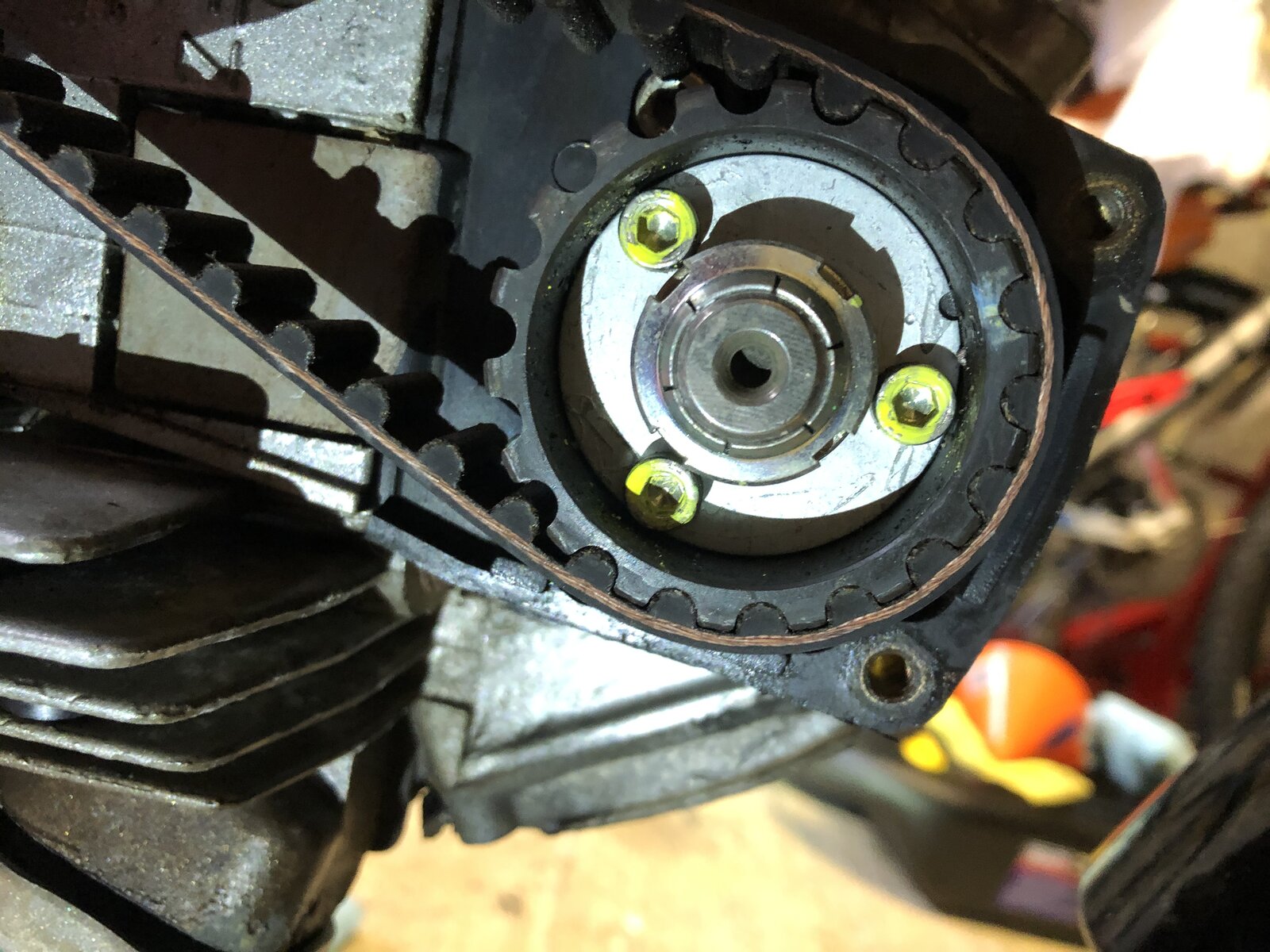

  1. 3C9A6344-7D8E-43F6-918D-3330A46F2D6F.jpeg Hi! Does anyone know what the torque spec is for the three bolts for the adjustable cam pulleys on a 2007 Ducati monster 695 (probably the same as a s2r or similar 2V)? I’ve checked my service manual and Haynes book and they’re not listed!!
    Thanks
  2. I would just go with standard M5 (if that's the size) torque. But take them out one at a time and use some nut lock on them.
  3. Thanks! Yes M5 according to the parts schematic. It never occurred to me that there was such a thing as ‘standard torque’. Useful to know. Good advice, thanks. I’ve got some medium threadlock somewhere I think.
