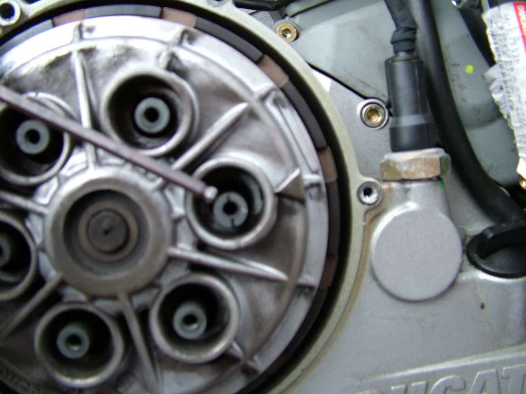

  17. Check the notched post is lighned up to the little triangle on the pressure plate.
  18. i have an aftermarket pressure plate, hope its got a mark on there.... also where is this notch? on the basket? ?
  19. On one of the 6 bolts the springs go on.
  20. If you have a slipper you won't have this.
