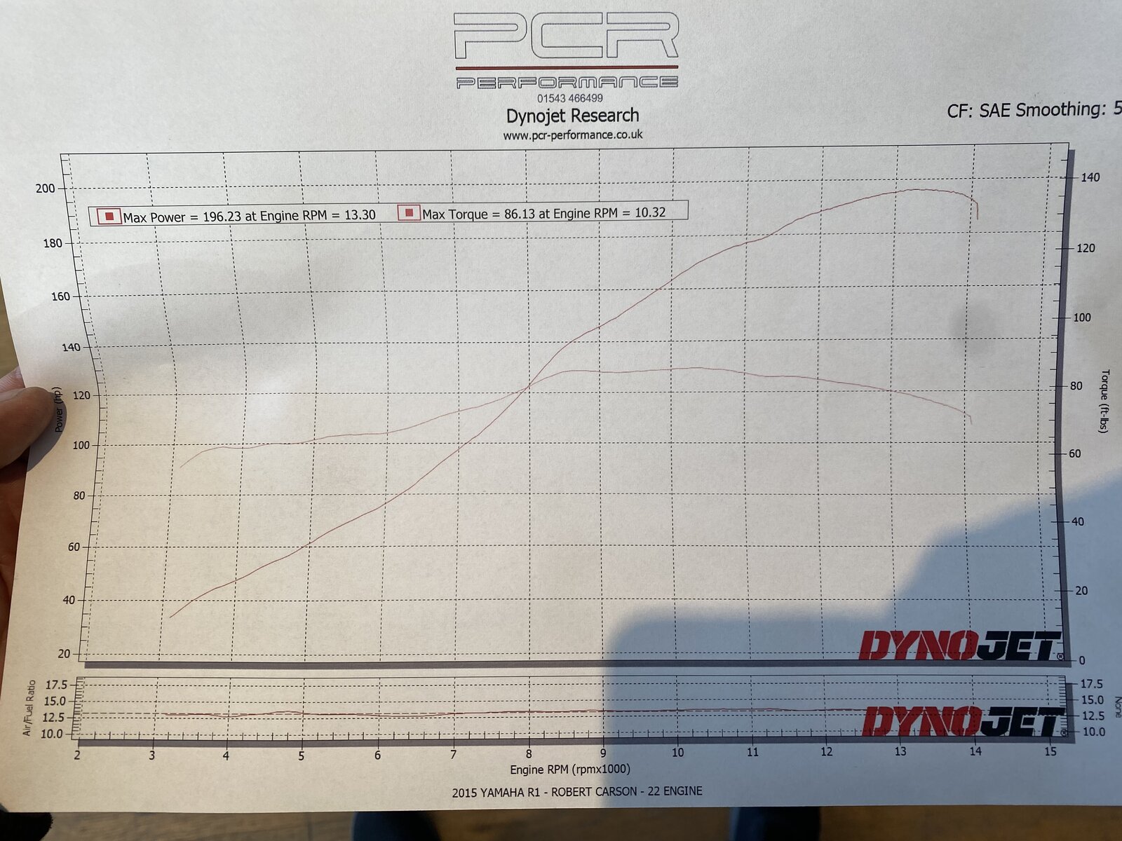

Brilliant bikes, wish I’d never sold my R1M but it wasn’t a great road bike to be fair, too full on! still run 2 2015/6 bikes on track and just put a new 2022 engine in the 15 bike using adaptor plates so I can run the 15 throttle bodies and electronics. Just had it mapped on Monday and really happy with the results ready for this season.
