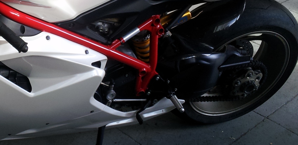

  3. Hi Anth,
    Picked up bike like it... Looks like it has standard rearset's levers etc... any pics or help of what needs changing etc.. Would e a great help...
  4. So your lever is not directly onto the gearbox spines and you still have a linkage rod from the forward facing lever to the gearbox?

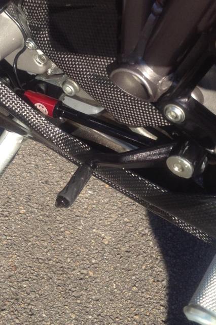

    Here is a recent picture of my new linkage with a quickshifter fitted.....if you can work it out from there.
    http://ducatiforum.co.uk/f77/hm-quickshifters-traders-section-5249/
    I'm not at home this week to get more pictures, but I'll search see if I have anymore with me.

  5. Umm..
    not 100% sure, will have a look @ the bike 2moz & get back to you.. If its missing.. What will I need to buy.....
  6. [​IMG]
    I found this one on my phone too.
    Try post a picture of what you have tomorrow.
  7. My rear sets can be set up for both. The gear link that comes directly out of the gearbox has a rod that faces straight up or straight down to the bar that meets the pedal. If it facing up, its set up for race shift and when it faces down, its set up for the road shift. Or so I understand :tongue:
  8. That would do it.....on some bikes it's possible to fit the splined gearbox connector upside down to go to race pattern, and some have two arms on them, so you can just change the linkage from one to the other to change over.
