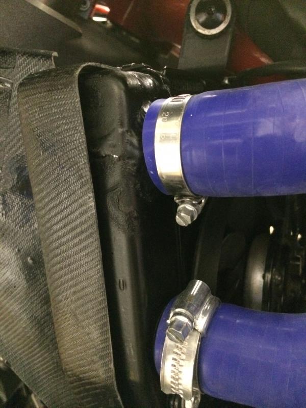

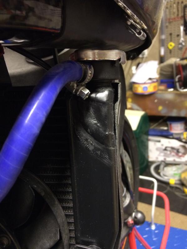

  12. I have enclosed a couple of piccies. hard to see but the welding is good and once the radiator cover and fairing panels are back on nothing is seen. 1098 repaired radiator 001.jpg 1098 repaired radiator 002.jpg
