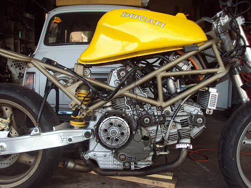

    SS frames are a completely different shape at the top to any other Ducati, (the angle of the top tube is much shallower) this means an SS tank just looks odd on a Monster or ST frame (IMO). Horses for courses but not my cup of tea. Here's a picture of a 1st gen Monster with an SS tank mocked up so you can see what I mean...
    Regarding the S4R, it's a 996cc water-cooled 4v, not air-cooled. one of these looks like an expensive way to get something you don't really want. If you're happy to go water-cooled then I'd start with an ST, not a Monster. They're virtually the same bike and half the price. Just my 2p...
    Cheers
    Darren
