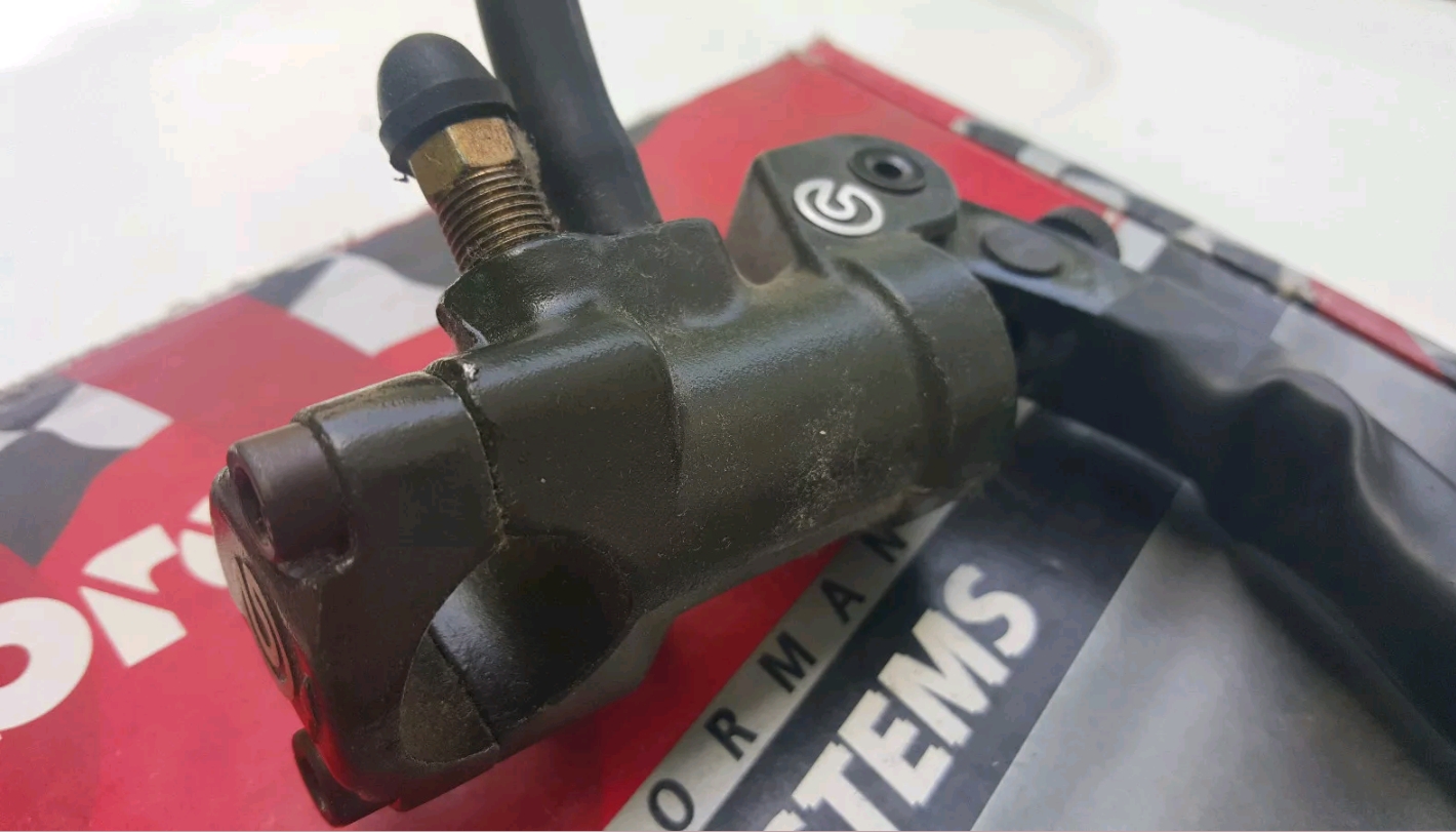

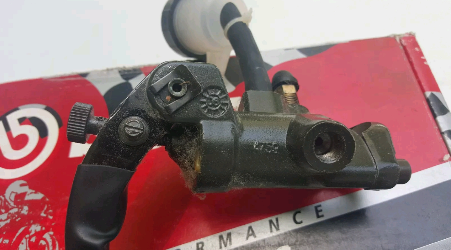

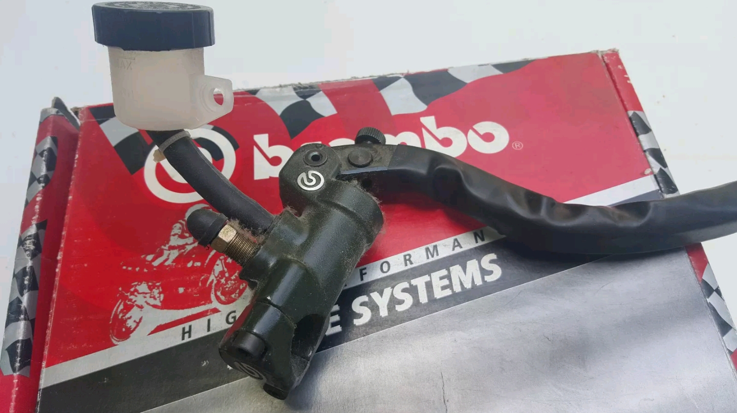

  1. I'm looking to buy a second hand Brembo Radial Master Cylinder but the seller doesn't know what size the mc is.
    Does anyone know how to identify the size?

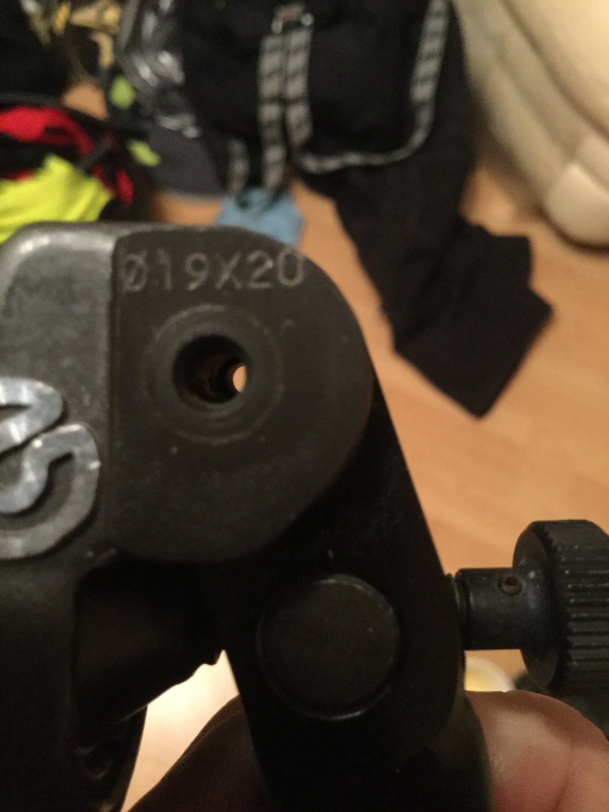

  2. 6C073246-D88A-4EEC-9455-27C7DCD70152.jpeg It will be stamped on the side of the m/c that you don’t have a picture of, like this. Andy
  3. Sorry, my bad. You do have a picture of both sides but it should have been stamped as my picture. 4759 is stamped on the barrel of mine so if there is any logic to it, it’s a 19mm diameter piston and 20mm ratio. Andy
  4. It’s late so forgive me. A 19/20 is suitable for a twin disc non Brembo caliper set up. That said I used mine on a 748R Brembo caliper set up and it worked fine if a trifle on or off with not much feel or finesse. Andy

  6. That's an old radial... date stamp is 2006. most likely need to factor in a service? You could use an OEM radial off a 999/1098 etc. 16mm

  9. I've got that very 19x20 master on my 916 with Brembo HPK radial calipers and I think it's just right. Plenty of power and feel, all the brakes you'll ever need with just 2 fingers.

  11. That looks pretty old and tired (also badly stored; no blank on the outlet). I wouldn't trust my primary braking function to that, certainly not without a comprehensive service.
